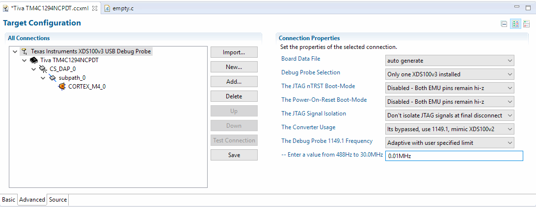

    I check connection on EK-TM4C1294XL by multimeter using signed holes of X1 part. Unused wires are not connected and simply free in the air. Length of the cable is about 7 inches. After your suggestion I tried to set lower clock frequency in advanced properties of the *.ccxml file (even 0.01 Mhz). But it still isn't work.

    Also please send me a snapshot of the ccxml file in Advanced tab where you set the clock frequency.
  • Please find the *.ccxml snapshot in attachment.
    My piece of XDS100v3 uses only JTAG TI 14-pin scheme (I guessed this because there are KEY on the 6th pin and three GNDs on pins 8, 10 and 12). How I explained before, there were no cable in the kit of XDS probe so I made my own and connected it as describes above. Should I implement scheme from Figure 1 of this wiki and additionally install 22 Ohm resistors? And what about unused pins? Also maybe 7 inches is too much for such cable? Or ICDI interrupts communication with target?
  • Hello user4299601
    Before doing anything else, change the option "The Debug Probe 1149.1 Frequency" from Adaptive to Fixed.

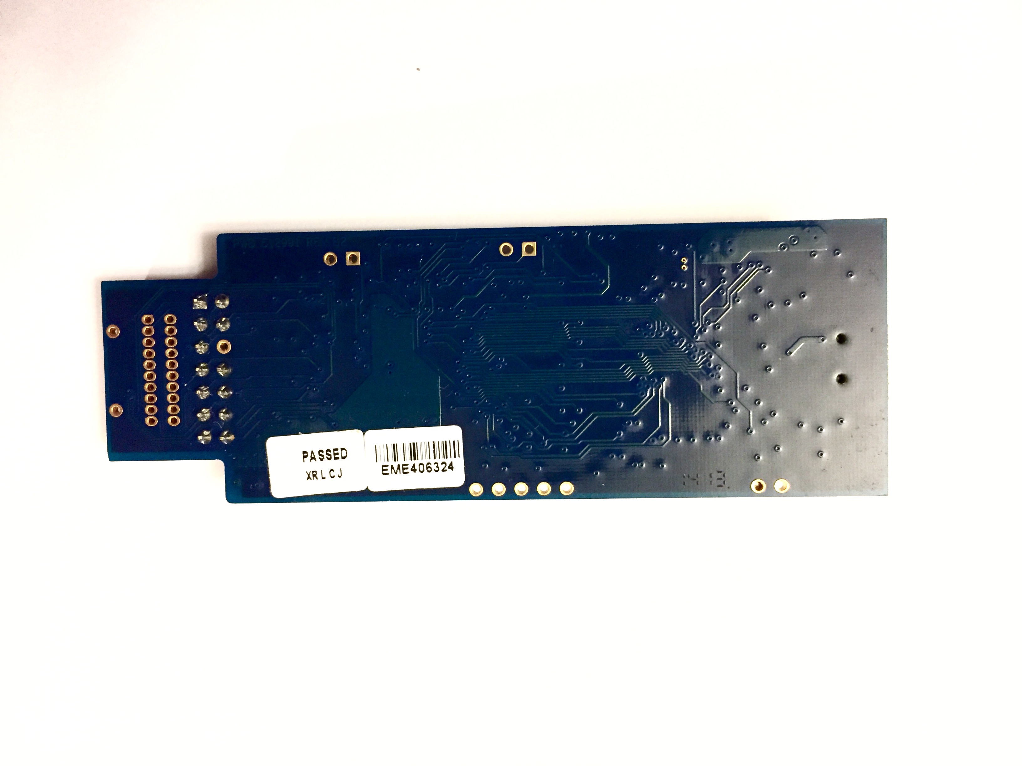

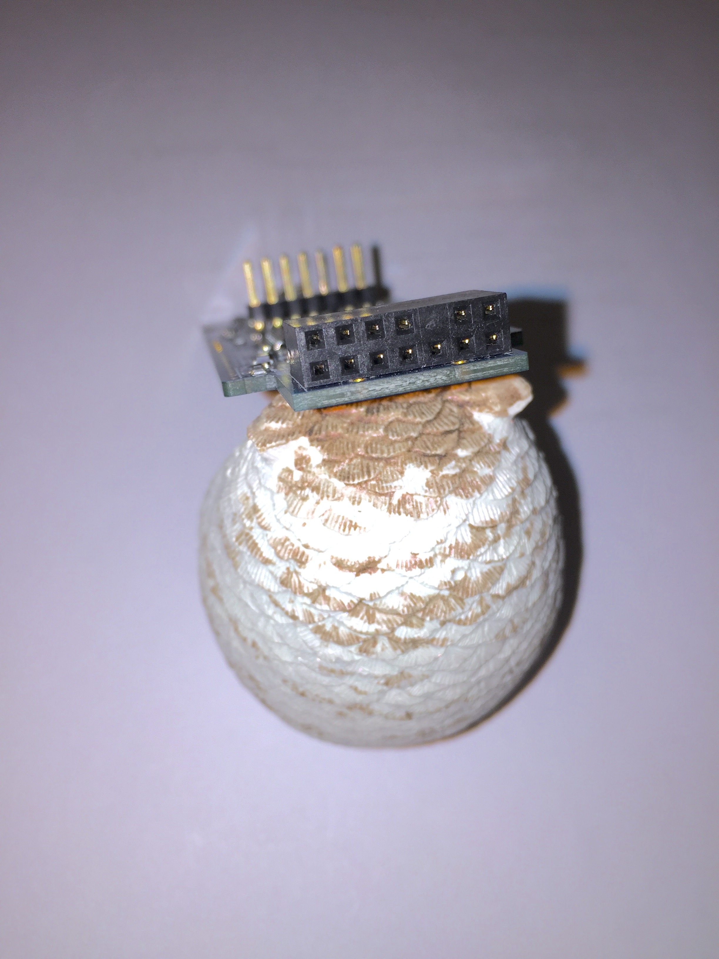

  • Finally, I have got it worked. XDS100v3 has two 14-pin headers and they are not equal. It was necessary to connect to the header on the edge of the board. Unfortunately, all this time I was connecting the target to the header that locating in the middle of the board.

  • I meant I connected 10-pin header of the EK-TM4C1294XL to the not appropriate header of the XDS100v3 probe. Attached photos show my instance of XDS100v3 and the header #1 is NOT what I needed and #2 is what I need. I found this from the scheme of XDS100v3 that can be downloaded from XDS100 TI-wiki article.
  • Hello user4299601,
    OK, Now I understand it better. May be I need to add XDS100v3 as well to the application document as well.
