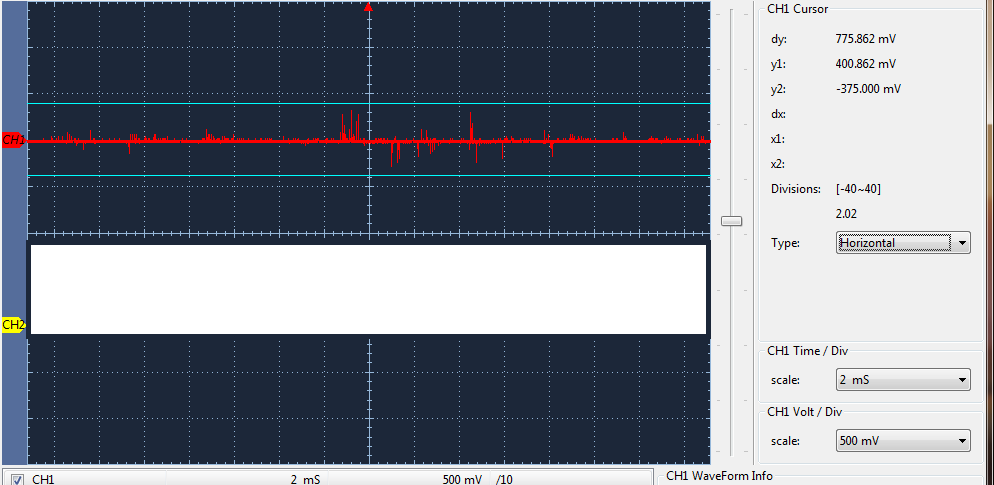

EK-TM4C1294NCPDT-XL: +VREFA source has 2.2uf, 0.1uf capacitors before R41 (0R0) into +Vref  and internal ADC +vref.
Added 0.01uf TP13 to ground +VREFA input seemed to reduce frequency of random false triggers.
Inverter transients could be false triggering internal analog comparator but not from -C0n circuit inputs.
Making R41 say R3k0 may reduce transient magnitude and seemingly change the precision resistor thresholds in ACREFCTL?
Perhaps add ultra fast 14ns Schottky diode TP13 to ground to arrest  any higher magnitude transients?
Scope capture  TP13, +VREFA CH2 AC coupling 500mv/cm.

    Have been reviewing TI voltage reference seminar. You have no idea if a series resistor would affect ACREFCTL thresholds? If we can trust the analog comparator ACREFCTL Fig 23-3 , R41 value would seem not to change the resistor ladder values.
    Don't see how an external reference would be any less prone to similar transients unless they are ADC switching capacitor injection pulses. Need to rule out if suspect ACREFCTL false triggers or if the -C0n inputs driven by INA282 current monitors are passing shunt transients. The INA282 has 50Khz switching capacitors SNR is 70db down @10Khz. Low side shunt Isolation to ADC inputs was the reason for selecting INA282 monitor.
    Seems unlikely a current shunt transient yet the PWM module M0nFauts are being tripped randomly at times. If it were shunt related that would be a huge 14.5 amp transient.

    With R41=10k, 0.01uf to ground at TP13, VREFP set VREFA+ the samples had much higher values, DC +161v was reading +243v. Switched VREFP back to VDDA, DC reads +161v again. They both use the same +3V3 source from JP2. Not sure how constraining VREFA+ to 330ua is causing the count to go so high compared VREFP=VDDA other than a few 0.1uf caps are now on the other side of R41.

    Scope probe TP13 (VREFA+) and the noise magnitude is much higher over (1v-ptp) with set VREFP=VDDA+. Seems R41 now acts like a low pass filter of VDD/ADDA 10k, 0.01uf to ground? Oddly no more random PANICS have occurred after R41=10k, hate when this happens makes it hard to know what to do. Did notice the TM4CXL-LP schematic VDD tied to VDDA+. Our custom PCB layout has VDDA+ tied VREF+ into R10K to a 5m ferrite bead at +3v3 (untested). Though now aware may have to tweak all SW sample filter values at some point.
    Considering LM4120 precision reference adding pads custom PCB for testing as well, fail safe gremlins may return. Do notice there is no ferrite +3v3 at VDD input but think could be prudent in this case but maybe 0R0 versus R10k.
  • Hello BP101
    1V ptp would cause a device reset if this is happening on VDDA.
