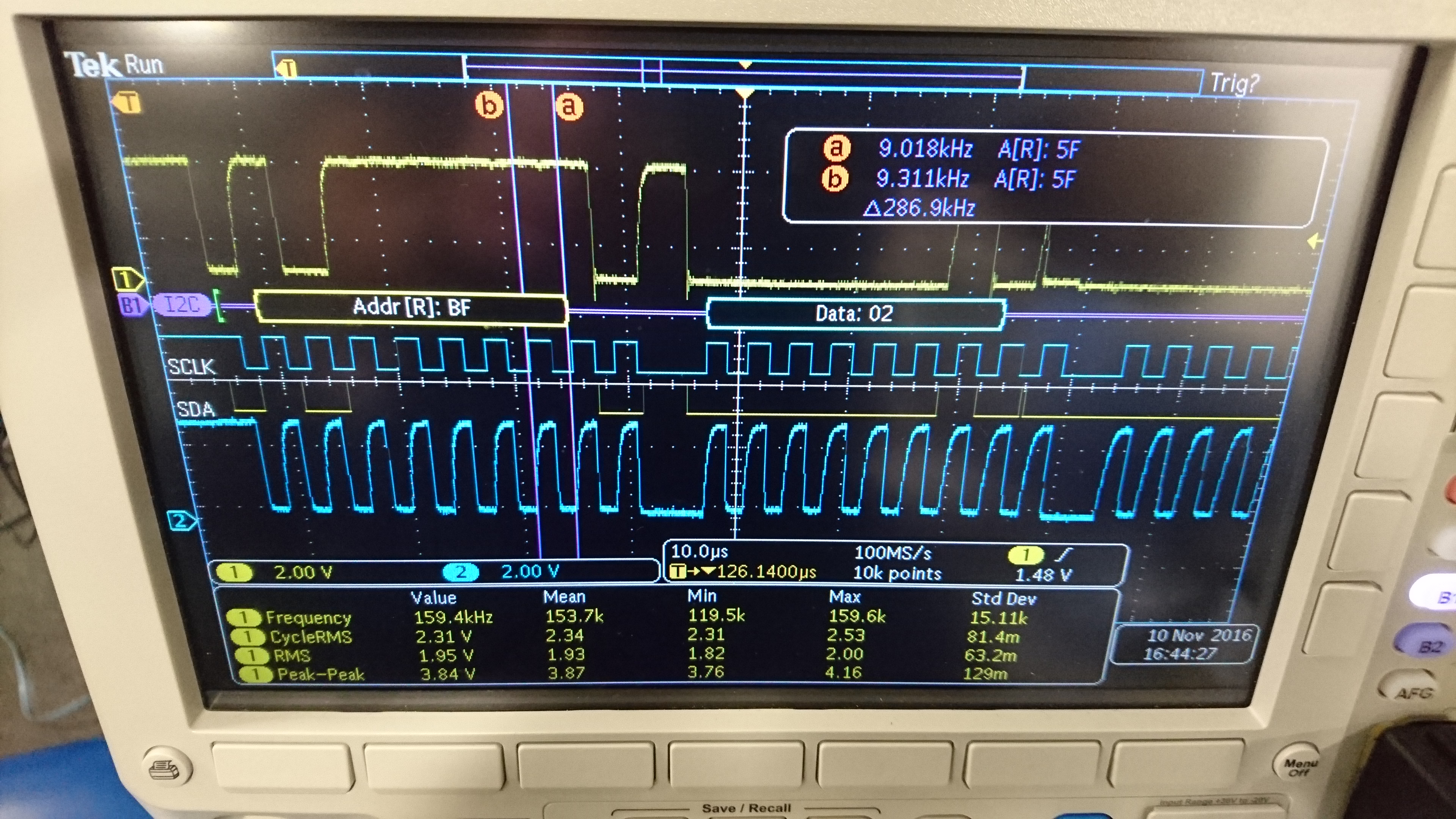

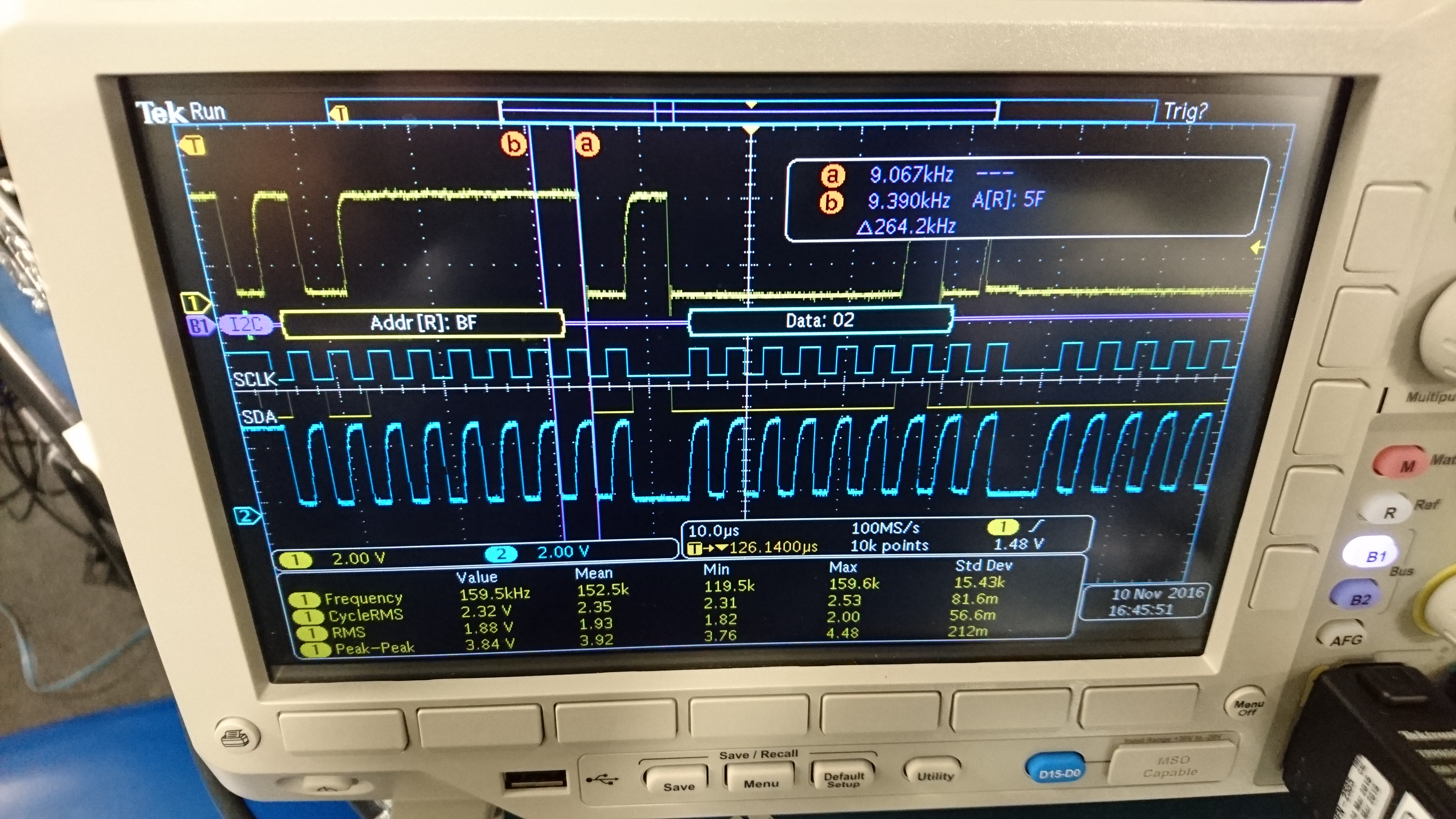

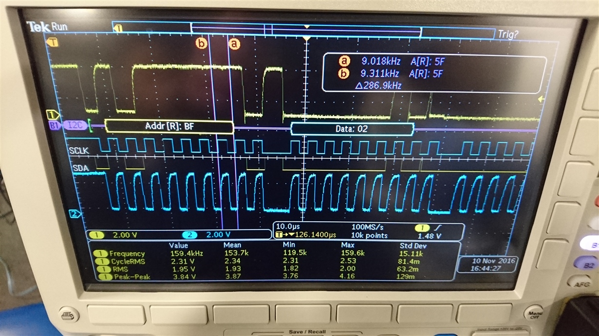

  •   Amit,
    1. I2C glitch filter is enabled with 31 pulse filter
    2.  I tried letting the function set this register and setting it explicitly to 6 then 5. With 6 I would expect a 357KHz clock and with 5 I would expect 416KHz. Neither worked as expected (screenshots below)
    3. Attached
    4.  It supports both 100KHz and 400KHz as specified in its datasheet.
