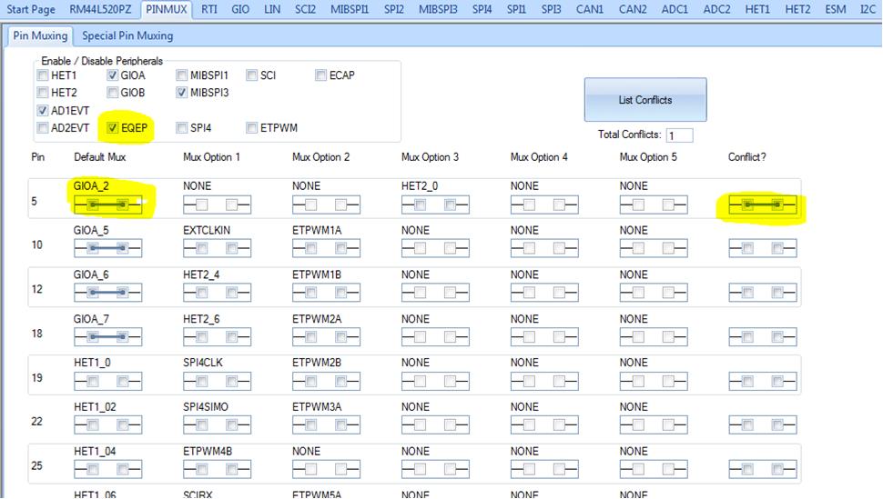

Dear Hercules-team,
my customer is trying to use the EQEP module and the GIOA_2 pin and is getting a "Conflict" for GIOA_2 when enabling the EQEP module in the PINMUX of HalCoGen v4.06 (latest release).
We do not see any specific relationship of GIOA_2 and the EQEP module.
Might this be a bug in the PINMUX tool?
Please provide a solution on how EQEP and GIOA_2 can be used independently.
BR,
Matthias
  • Matthias,
    Thanks - this is a bug in the pinmux tool.
    The generated code to me seems ok:
    pinMuxReg->PINMMR2 = PINMUX_PIN_5_GIOA_2 | PINMUX_PIN_10_GIOA_5;
    in the sense that it still selects GIOA_2
    So you could suggest living with the issue for now until we fix it. I'll file a ticket. But otherwise there could be some XML edits made into the HalCoGen folders which might remove the 'conflict' bar but that would not really change the outcome in terms of code generated. So probably not worth doing it.
    -Anthony
