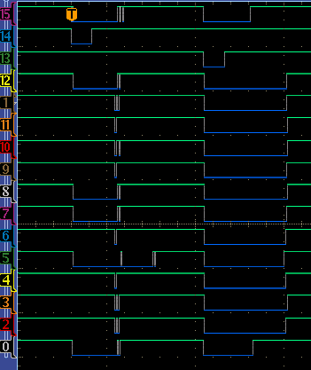

    The shot below is when it works.
    The top three lines are:
    1. An address line being used as a chip select.  It is hooked to EPI0S19
    2. RDn (EPI0S28)
    3. WRn (EPI0S29)
    EPI0S30 is being used as a chip enable elsewhere on the board but is not shown here.  Basically, there is a 74245 whose enable line is hooked to EPI0S30
    , so the address line will be a chip select as long as EPI0S30 is asserted.
    All the other lines are data lines with the bottom one '0' hooked to D15 EPI0S15
    The value for the write is all zeros.
    Here's the same program with the only change being that we are now writing a 0x8000 to the address:
  • In case you really want to see EPI0S30, here it is attached to a real scope probe at the bottom of the picture:

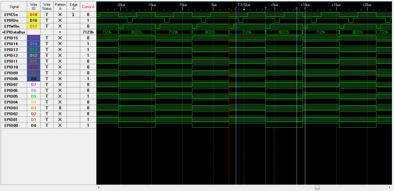

  • The logic analyzer shown is actually pretty far away: a couple transceivers and a 40 pin ribbon cable on another board.
    The reason being that the other board is mid 1990's tech with nice .1" center pins that you can attach probes to.
    The board with the Tiva is all teeny tiny surface mount that is hard to probe.
    So I bit the bullet and looked at the EPICSn line coming out of the CPU and it looks like this:
    Obviously some contention going on.
    Let's just call finding this contention the answer shall we?
