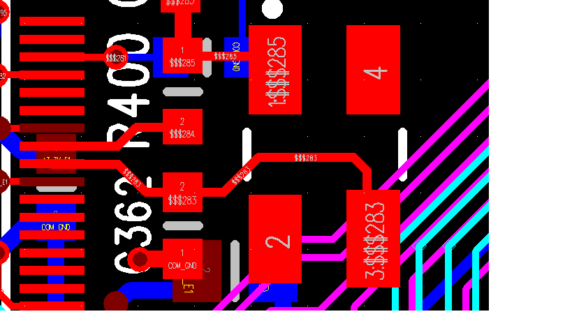

We test the TM4C1294 board ,at beginning the interface of ethernet works well under normal temperature, but when the temperature goes under -30℃,the ethernet fails. I want to know why , the datasheet shows that TM4C1294 can work under -40℃。
Hope to get reply soon.

    3. Layout information of the board.
    4. Signal quality at room temperature and at low temperature.
  •  We did'nt use RBIAS resistor. We use liquid nitrogen  to drop the temperature of the  crystal , it works well .But when we spray the liquid nitrogen onto TM4C1294 , we see the wave of crystal disappear on the oscillograph ,after a while ,the wave appears again.So we think the crystal works well under -30℃, but TM4C1294 can't work well under that temperature.The signal quality at room temperatrue and at low temperature didn't  have obvious difference.

    I mentioned an external single ended clock generator, so that there is no other component except TM4C129x. Also I checked on the device characterization and ethernet PHY tests have been performed at -40C across devices and there has been not a single failure seen.
    I agree with Robert. May be the device temperature is lower than -40C.
  • We did the test in an  environmental testing chamber  at first ,so we can get the accurate number of temperature ,-30℃ under which ethernet dosn't work. We use ethernet to communicate with PC outside  environmental testing chamber,when temperature goes below -30℃,communication dropped.
    After that ,we use liquid nitrogen for convenience to do our experiment because we need to weld some wire on the board ,if we use environmental testing chamber ,it cost time .We do the test in order to find which part caused the failure.

    OK. Now a couple of things to check
    1. Check the stability of the 3.3V supply and 1.2V core voltage when the freeze is applied. Is there a dip/power loss
    2. Is each board having the same issue. If not then, replace a working part on the failing board and then check.

    I too agree with you and cb1. If it is now a single board or multi board anomaly needs to be understood,
  • On this board ,there is not only TM4C1294,but also other TI mcu ,such as TMS570xxx,they work well under -30℃.So I think solder joint,cracked trace,and so on are not the reason why TM4C1294 fails.
  • I would not take the fact that other processors do not show an issue as good evidence that there is no issue with solder, cracked traces etc... Those often show up in single locations. Either because of process issues, design issues or handling.

  • Hello Jiaming,
    I think based on the evidence provided so far, we would like to know if this issue is device endemic or board dependent? The experiment of testing multiple boards and device swap would help us follow up on the next course of action.
  • We do the test that downloading very simple porgram such as flipping the IO ,TM4C1294 could work well under -30℃.If we add ethernet code into program ,the chip failed under --30℃.From this phenomenon ,could you give some advice?
  • Test on multiple boards
    Robert
  • Hello Jiaming,
    A single device test is not conclusive. As everyone else on the forum is suggesting the same, please try multiple boards.
