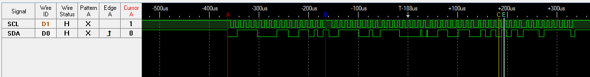

But, the actually result measure from oscilloscope seems always fail in first four bytes value after response slave address to master.

Customer did a simple test: after repeated start, slave always write 0xF0
The test waveform is Fig1 and Fig2(Fig2 is a continuation of Fig1)
Red(marked 1) – response slave address
Orange(marked 2) – slave write 0xF0(sometimes will be error)
Purple(marked 3,4,5) – slave write 0x00(should be 0xF0, they are error)
Green(marked 6,7) – slave write 0xF0(they are right, from marked 6, slave write will always right)

Please find the picture as attached. thanks!

  • Hi Ashara,
    This issue only happen when master issue master write read with repeated start.
    It works well if you split as master write and master read in master side.
    The simple test code which you provide only contain master read action instead of origin status.
    Here are the simple test code in my side:

    This simple test code will get correct response once you issue master write and then master read.
    But, once you use master write + repeated start + master read, it will always return error data in first four bytes.
  • Hello Wu,
    Got it. I will retry the Master Write + Repeated Start and Read and check.
  • Hello Wu,
    I modified and reran the code and it works as expected. Please see following attached code and the snapshot as captured on a LA
    The Master writes 0xCD, issues a repeated start and reads the data.

  • Hi Ashara,
    We confirmed that  this issue cause by some slave device response at the same time in same bus due to some hardware design issue after do some testing and signal measurement.
    It cause response signal merger at first four bytes after repeated start.
    Thanks for your support in this issue.
  • Hello Wu
    Thank you for the confirming that the issue is not with the TM4C123x device. I would mark this thread as closed.
