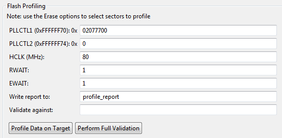

Can someone point me to some information on how the flash profiling feature of Code composer studio is supposed to be used and how the results can be interpreted?
I am trying to profile sector 0 of bank 0 on the HDK board, with the settings depicted in the attached screenshot and I get a timeout error. (target not halted before timeout).
Mathieu
  • Correcting my first mistake and setting the PLLTCTL1 to 0x00077700 doesn't help.
  • Actually got it working. It seems the HCLK divider is set to one so I have to adapt PLL settings accordingly. Would appreciate some information on the parameters collected though.

  • Hi Mathieu,
    Are you using bootloader in your application?
    I think the flash profiling is useful if you use a non-CCS tool to download your application. For example, if you have a bootloader you would download/update your application by running the Flash API. Sometime an incorrect use of the Flash API can adversely affect the qualify of the program image being programmed to the flash. The flash profiling allows you to profile the quality of the programming vs. how it would have been programmed by using CCS.
    Below will be the validation steps:
    1. Erase and program data into each device using the tool to be validated.
    2. Erase and program data into each device using the tool to be validated again to ensure both the
    erase and program were performed. The reason to repeat step 2 for one extra erase/program cycle is because the parts that are shipped to the customers are blank. The step 1 will not go through an erase cycle since it is already an erased part.
    3. Profile each device.
    4. Erase and program the same data into each device using CCS and the same settings as the previous
    tool. So when you asked what parameters to use, you will put in the same parameters you used to program the application in the tool to be validated (i.e. the parameters like the frequency, wait states you used in your bootloader to run the flash API commands). If different settings are used, this could skew the data causing the results to fall outside the limits.
    5. Profile each device.
    6. Validate whether the average measured Vt (voltage threashold) and Bcc (Bit cell current) values are achieved using the tool to be validated, are within the limits of the average values achieved using the CCS tool.

  • Hello Mathieu,
    VtrefPV should be the index used as the program verify index, basically the minimum voltage point for a bit to be initially programmed to a zero. VTRefRv I expect to be the voltage point that is used to determine if a bit is a one or zero, but the numbers I am seeing don't look right. The BCC measurements are "bit cell current". The voltage needed to turn on the gate of an erased cell is so low that it is hard to distinguish how well erased the cell is. Instead we put a set "read" voltage on the gate and then measure the current. The BCC indices represent the current.
    In short, we measure how well programmed a cell is by finding the voltage that gives a set "read" current and we measure how well erased the cells are by measuring the current when a set "read" voltage is applied.

    In regards to your earlier question, the profile operation should not erase the flash, but if you choose "Perform Full Validation", it will. While the Vts and BCCs will vary from device to device because of process variation, on a single device they should be pretty consistent from one programming cycle to the next. The purpose of the validation is to show that a customer implemented algorithm programs and erase the flash the same way as TI does using Code Composer. For example, if you write a boot loader and want to verify that it programs and erases properly, you use the boot loader to erase then program some sectors. You select those sectors in CCS and then perform the validation. CCS will first profile the sectors chosen, then erase, reprogram and re-profile the sectors. Then it will compare the first and second profiles to see if the extremes and means are within limits defined by TI.
