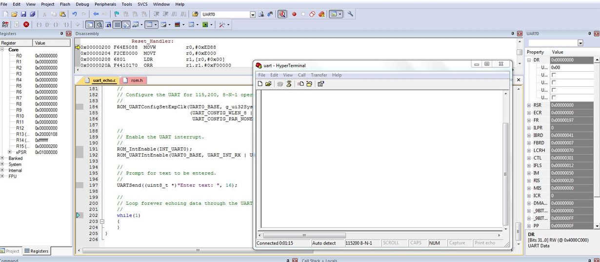

  • Thanks Amit,
    1) I am using Keil uV5.20 IDE, I have included the given startup file "startup_rvmdk.s", and there the interrupt  is mapped as follows "ROM_UARTCharPutNonBlocking" >> "ROM_UARTTABLE[15]" >>  UARTIntHandler()
    2) I have tried the same using Hyper Terminal console while the same code in execution. But it is not displaying any data in console terminal as well as the "System viewer" >> "UART0" >> "UART_DR". The value in UART_DR_DATA is 0x00 always. Please find the screen short of the same. Hope someone have a solution for this.
    Thank you very much.

    - Code does not seem wrong, and all the pins appear to be properly mapped and peripherals enabled. Did you triple check your UART port on the PC, are you sure it works? Maybe upload an example firmware to your board which you are SURE that sends data via the serial port... I suspect the PC, as you are not even receiving the initial message.

    • So far on troubleshooting. I have observed that after "ROM_UARTConfigSetExpClk()" baud rate configuration the UART_DR register (Value: 0x00000500) is giving break error and framing error

  • Hello Kurian,
    I did mention to run an example which uses UART0, as we need to test if the UART is working correctly. A break and framing error indicates a mismatch on the baud rate. Did you check the windows manager setting for the COM port in question.
