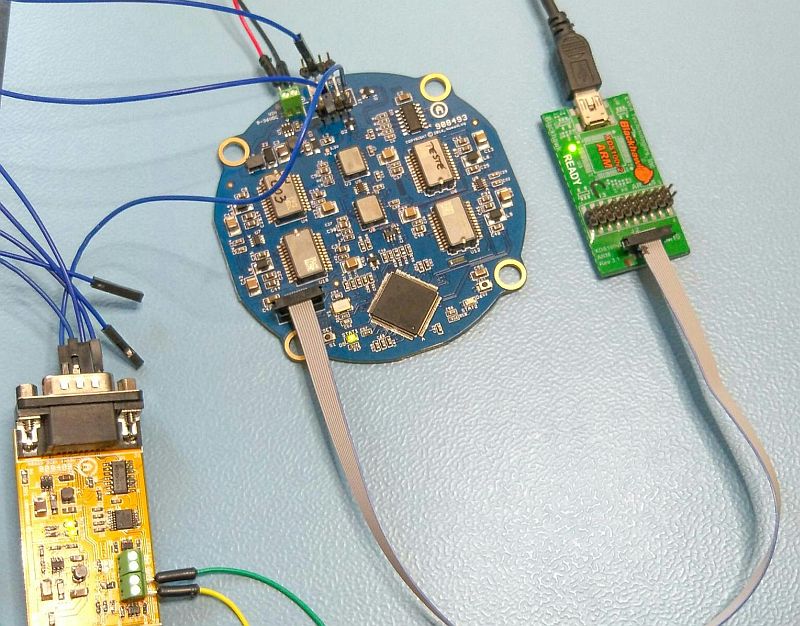

I am new to TIVA C MCU. I am using TM4C123GH6PZ microcontroller.
1) Which emulator I use for TM4C123GH6PZ mcu. I have XDS100V2 emulator
2) How many pins I use for JTAG
3) As per datasheet it shown 10 pin but in software & tool on your website it shows 20 pin xds100v2
please reply me as soon as possible

    You can read this post with a long discussion about emulator options, and some experiences:
    e2e.ti.com/.../358729
    The XDS100V2 you have is just fine. Note that the Launchpad boards already come with an "embedded" emulator, called ICDI, in which case you don't need anything else to start.
    Look again, there are different versions of XDS100V2 on the TI store. For ARM, you want the small 10-pin connector, which happens to be .127 pitch in two rows of 5. If you already own a 20pin emulator, you can build an adapter cable (I have the part numbers written somewhere if needed).

  • Hello Sumit
    Another useful resource would be the following Application Note for interfacing JTAG with TM4C12x devices.
    www.ti.com/.../spma075.pdf
  • I have blackhawl xds100v2 ARM emulator. It has 10/20 pin JTAG Connector. I don't have launchpad of TivaC 123. Is this xds100v2 ARM is sufficient or not for TM4C123GH6PZ?
  • Yes it is sufficient.
    Make sure you design the proper JTAG communication into your TM4C123.
    Here is a picture of an XDS100v2 connected to a Tiva MCU on a custom board. This one has the smaller 1.27mm connector, but if are the board in which the Tiva is used is your design, you can choose whatever connector suits you.
  • Thank you very much Sir for your prompt reply.
  • Hello Sumit,
    Yes, it is. The Application Note also shows the schematic connection to be made for JTAG on custom board. Please make sure you follow the same.
