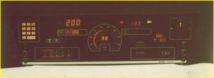

    We appear to have similar interests - here's a "digital dashboard" we produced for Ferrari - circa mid '80's!    (I (still) have the 308GTB which received this "slip-in" instrument package.)
    That circular (120 element) bargraph (Tach, center), and dual, linear (200 element each) bargraph (Fuel, Volts) left, bottom were both from "Burroughs."   They were most unique (hypnotic) Plasma Gas Discharge Displays - and appeared w/in several movies & TV shows.   There's a digital compass & security system and each/every critical sensor/system was monitored & examined/set via the illuminated keypad.
    We were approached by Detroit's Big Two - were "counting the money/deciding upon (which) island to buy" when it was discovered that the mercury content (required) by these displays made them "unsafe" to store in volume.   ("Hello, Island Sales - About that isle purchase...)
