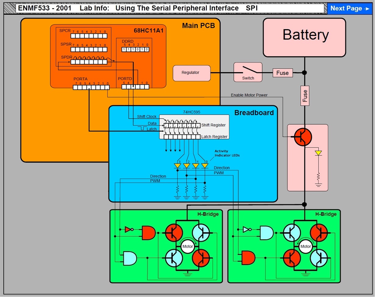

  • Insofaras "A picture is worth a thousand words", how can I post a picture?
  • Hello David
    In the reply pane, use the "Use rich formatting" link at the bottom right.
  • Click upon, "Use rich formatting" (found beneath the post area, left side (when you're responding).
    The 10th icon (from the left), bottom row, marked (when moused over) "Insert/Edit Media" enables you to "pull" from your PC.
  • A sketch from 15 years ago to illustrate elements of automation to mechanical students...
  • Nice drawing - that HC11 may (even) exceed that 15 year marking. And those are bi-polar transistors - replaced by far more efficient FETs.

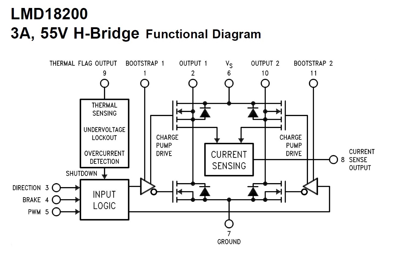

    We should note that today there are "Integrated Devices" which include "all four" FETs (i.e. "H-Bridge") - speeding, easing & enhancing "Brushed Motor Control."
  • HoHo. Yes indeed. The actual H-bridges were the venerable LMD18200 which simplified design considerably.
