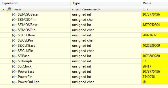

  • Certainly Amit!
    Here's a print of hwssi right after it receives the values from hw at the beginning of the function.
    No need to compare to the previous image, suffices to say that probably only the first element is identical. Visually, lots of the lower ones are different.
    HOWEVER, having noted that it was a mess of 8-bit values in the middle of 32-bit ones, I added #pragma pack(push, 1) before the struct definition and pack(pop) after, and it is now working again. There's something on the compiler (or somewhere in the middle...) that was apparently optimizing the alignment of the struct in one part of the code and not on the other?

  • Hello Bruno,
    The values shown is in decimal format. Right click the structure and view it in HexaDecimal format to see which element is incorrect.

    Amit,
    I am aware these images are showing decimal formats... The dance of print screen/copy/crop/save and so on is too complex to inspire me to generate a whole new lot of images with hex numbers - but that being said, the thread is still valid as decimal elements #3, 5, 7 and others are easily seen to be different.
    Still - the pack push/pop mentioned earlier fixed things. So this matter can be put to rest. Wheather this was to be prevented by compiler/linker or not, it's up to different folks to say!

  • Hello Amit!
    Sorry, I had no meaning to sound rude!!! So much on my mind these days that I believed the post sequence was clear...
    There was an image on the first post - a print of the elements at the calling of the function - and then, further on, there is supposed to be an image of the elements of the variable inside the function. One should have the same values as the other, but several elements were different.
