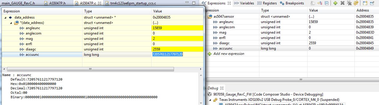

Two debug windows, same variable, two different values...
Fellows,
This is a screenshot of CCS 6.1 trying to debug TM4C123x. This project suddently began to give me all sorts of headaches...
The displayed variable is called as5047sensor. It is stored in location 0x20004835, as can be seen both on the yellow pop-up window and on the while expressions window.
The element accuunc was recently set to 0, and such attribution in fact worked. The value on the right (white) part of the image is correctly 0, in address 0x20004849. However, on the same moment, the yellow popup shows a huge number (all formats properly visible there):
There is something quite weird with that variable, as the next line would try to access as5047sensor.accuunc, but that causes a FaultISR.
Patiently tried to debug the FaultISR as per available documents, but found no evident cause. I know not enough assembly to figure this out, but there was nothing popping out as too illegal. Checking the NVIC fault registers, one hint is a bit set on Unaligned Access Usage Fault.
Further info: general interrupt is disable at this stage.
Any suggestions are most welcome!!!
    Some questions:

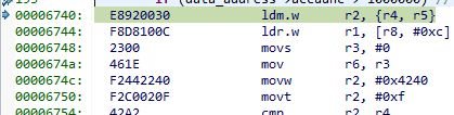

    1) If you single the assembly in the CCS debugger, can you find which instruction causes the Unaligned Access Usage Fault on the access to the 64-bit as5047sensor.accuunc?
    2) The CCS debugger expression view shows some of the other 32-bit integer variables are not aligned, does the code access those unaligned 32-bit integers correctly?

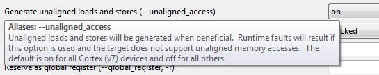

    3) Are you using the TI ARM compiler, and if so have you changed the --unaligned_access option?
    This option defaults to on for Cortex devices, which tells the compiler the target supports unaligned accesses for 16-bit or 32-bit values.

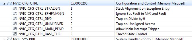

    4) What is the value of the UNALIGN_TRP bit 3 in the Configuration and Control Register (CCR)?
    The reason for these questions is that the UNALIGN_TRP bit when set allows instructions to generate unaligned 16-bit and 32-bit accesses, but Unaligned LDM, STM, LDRD, and STRD instructions always generate an Unaligned Access Usage Fault.
    See the ARM Cortex-M4 documentation 3.3.5. Address alignment and 4.3.7. Configuration and Control Register
    The yellow pop-up shows the least significant 32-bits of accuunc are zero but some higher order bits are set. That might be a bug in the CCS debugger.

    1) Yes, assembly debug was possible. As the code changed a bit for debugging, and since the problem is gone after I rearranged the structs to avoid odd positions, I won't have the exact location. But I remember it was one of the wide-value access instructions of the image below:

    3) Yes, using TI v5.2.8 compiler. A couple of days ago I was still using 5.2.7, any chance that the simple presence of 5.2.8 modified some alignment directive?
    I have surely not changed specifically this alignment option - I probably never needed to access the Runtime Model Options page where I just found the related entry. And in fact, it is ON. Should OFF be a better option for TM4's? I checked a different, older project, which is compiling with 5.2.7, and it also shows ON - but probably all of these related projects on my workbench are pasted from some similar base project anyway...
    4) UNALIGN_TRP bit was tricky to find... here they are for today's status:
    And yes, the 0 value on the yellow popup versus the ugly value on the green variable monitoring seems to be a bug - does these things get forwarded to whoever needs to look into that?
    The Cortex-M4 requires the memory address for LDM and STM instructions to be 4 byte aligned, and if the memory address isn't aligned a "Unaligned Access Usage Fault" will be generated. I created the following example program using the TI ARM v5.2.8 compiler:

    It was compiled with the default --unaligned_access=on. The program contains two structures which have the same layout, but one is marked as packed with one byte alignment (packed_struct) and the other doesn't having any packing specified (unpacked_struct). Both structures are of size 16 bytes, with an 8 byte field long_word at offset 8.

    a) For the unpacked_struct structure the compiler uses ldm.w and stm.w instructions to access the long_word, and thus the address of the long_word field must be 4 byte aligned.
    b) For the packed_struct structure the compiler uses pairs of ldr / str instructions to access the long_word field, and with the Cortex-M4 which supports unaligned word accesses the address of the long_word field doesn't have to aligned.
    When the example is run:
    - The unpacked and packed variables which have four byte alignment can be modified successfully.

    In conclusion as of TI ARM compiler v5.2.8 the behavior appears to be:
    1) If a structure is packed the compiler doesn't appear to use ldm / stm instructions to access 64-bit fields, and so the 64-bit fields can be accessed even if not 4 byte aligned.
    2) If a structure is not packed the compiler uses ldm / stm instructions to access 64-bit fields, and so the address of the 64-bit field (and the start address of the structure) must be 4 byte aligned.
    Therefore, ensuring all your structures are marked as packed *may* allow 64-bit fields to be used without any requiring any alignment. However, since the compiler documentation doesn't specify the conditions under which ldm / stm instructions are generated you would be relying upon undocumented behavior, which may break the code under some conditions.
    The test project is attached TM4C129_alignment.zip
    [As an aside I found there is a hidden --no_stm TI ARM compiler option which prevents the compiler from generating stm instructions. However, --no_stm is only intended to be used to avoid a Silicon errata on some Hercules Cortex-R4 based devices and the compiler reports an error if attempt to use --no_stm without use of -mv7R4. See RE: C compilator and TMS570LS3137 bug DEVICE#B064 ]
    From a quick look at the generated code, turning --unaligned_access to Off generates can generate more code if the memory address of a load/store might not be aligned. Given that the TM4C devices can handle unaligned half-word or word accesses don't see the benefit of changing --unaligned_access to Off.
    Also, changing --unaligned_access to Off doesn't prevent the compiler from generating ldm / stm instructions for accesses for 64-bit fields in unpacked structures, and so wouldn't have fixed your problem.
