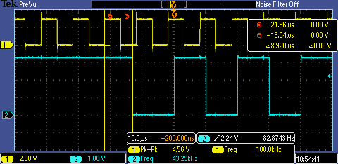

After running some test I noticed that the data that comes out from the operation in Timer1IntHandler() is only really accurate between the frequency ranges of 50 kHz and 160 kHz. Below 50 kHz the incoming data is scrambled and nothing of value can be extracted. Above 160 kHz, the microcontroller completely halts.
I got some advice to toggle a spare gpio pin (PD1) in the interrupt to see what it does on an oscilloscope, here are my results.
Note: probe 1 is the incoming signal from a function generator
           probe 2 is the gpio pin being toggled

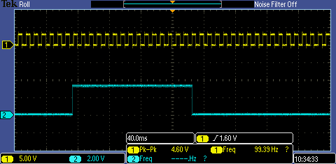

At the 100 Hz frequency I tested, the interrupt doesn't trigger often enough and misses most of the incoming edges that it should be detecting.

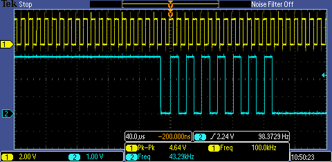

When the frequency is raised to the 100 kHz range, the interrupt triggers several times, drops out, then triggers several times again. The following image shows when the interrupt is toggling the gpio pin

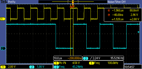

There is also noticeable latency in the first interrupt, here it is 8.92 microseconds
But each successive toggle (until the interrupt stops triggering for a random amount of time) has a latency of about 1.7 - 1.9 microseconds after the nearest edge.

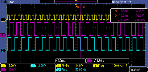

  • I've got an update with some success!
    When playing around with placing another toggle pin at different parts of the code to see what was slowing down my process I found out that it would toggle and hold where I had a breakpoint that was set up to update the expressions view on the Code Composer Debug Mode.
    Here is an image of the new waveform
    Probe 3 is the new toggle pin, which can be ignored right now. But Waveform 2 is triggering at 1/2 the frequency of the input waveform(1) as it should be. So I suspect that updating the expressions view is what was holding up the processor.
    Now I just need to figure out making each timer tick wider so I don't get so much rollover at these frequencies. The approach seems to be doing this with a prescale on the timer that I'm monitoring, any advice is appreciated! I'm pouring through the other forums as well here, but I'm danger close to the solution!
