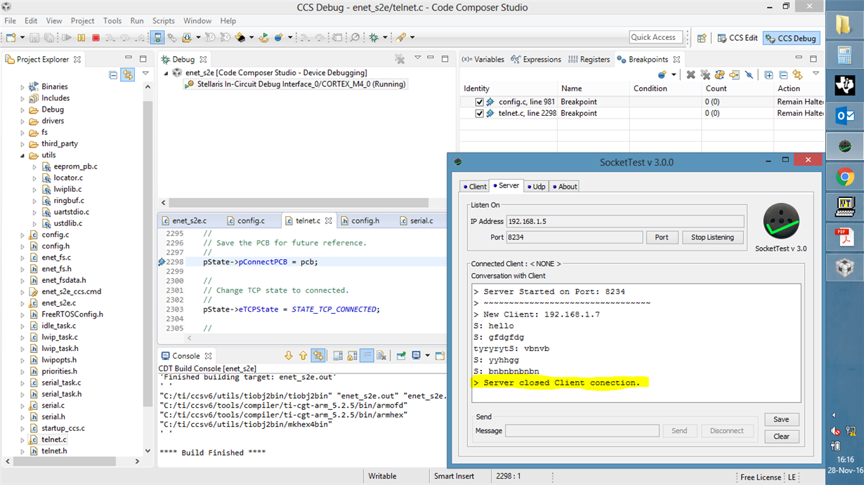

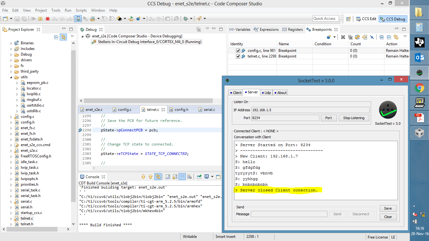

    Now my problem of cable plug/unplug is resolved. Other problem is that I need to know whether my client (DK-TM4C129X kit) is connected to server or not.
    There is one enum that tells TCP state, below. Sometimes i found that state of my TCP session is STATE_TCP_CONNECTED but server (PC) is showing no connection with client. It happens randomly may be after 2 hrs or 5 hours. How can i check that my client is actually connected with server or not in this code ??
    TelnetPoll function is called periodically to check a dropped connection but in this case it is still showing STATE_TCP_CONNECTED while server is showing not connected. What modification can i do here in this code to check whether server and client is connected.
    Typically when i close server then server sends session close packet to client and client come back to STATE_TCP_CONNECTING after receiving the close session packet.
    Pls suggest. Thanks
