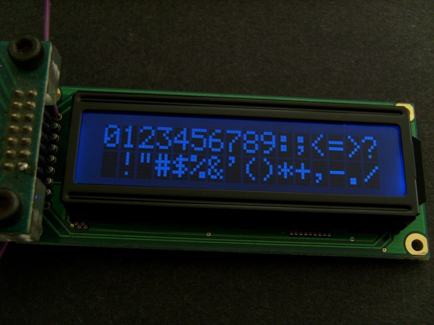

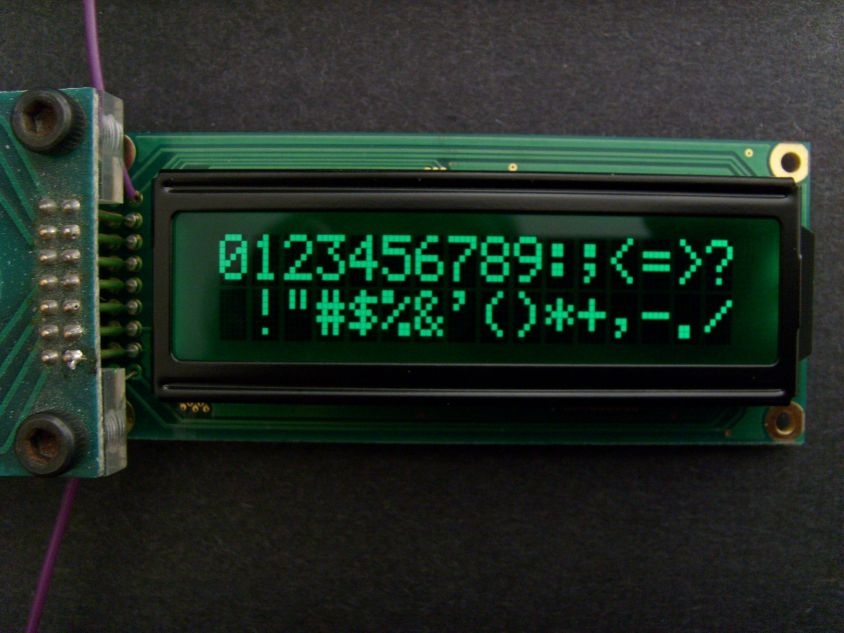

    I have used the same device P1602 some six years ago, with another brand micro and the delays were software, similar to SysCtlDelay in Tiva.
    You can attach your .c file here, to be inspected by the community, downloading a .zip from another site may be harmful.
    Some more hints : the device is a +5V one,  hope you noticed that, the data sheet request levels  >3.3V.
    Check also the adjust voltage.

  • And - arrives now (after mistaken entry to another thread):
    Rather than "hope, pray, guess" that your (likely) discount Display works - might a "more active" means prove superior?
    illustrated here is a method to, "Solderlessly Connect" - and quickly/easily - verify Display Operation.   (and may be employed repeatably)
    No funds/effort were spared in the creation of this "Display Solution. "    A  "binder clip" intended to hold sheets of paper is attached to a pcb which holds, "Spring-Loaded" Test Pins which are cabled to a small, ARM MCU.   Such enables, "No hands, Lcd testing!"    Different clips may be designed - fed from the same small MCU board - to accommodate a variety of displays employing different signal connections/types/pitches.
    This device, "Speeds, Eases & Enhances" the Test/Verification of multiple Displays - and eliminates all Soldering.  (almost all! - pay no attention to the 2 wired connections which service the, "R-G-B" Led Array Backlight.    (just ONE Lcd is shown - w/the backlight drive changed to alter color...)
    Crack staff photographer (promises) to consume (less) adult beverages prior to next, "shoot."    (promise was made earlier - iirc...)
