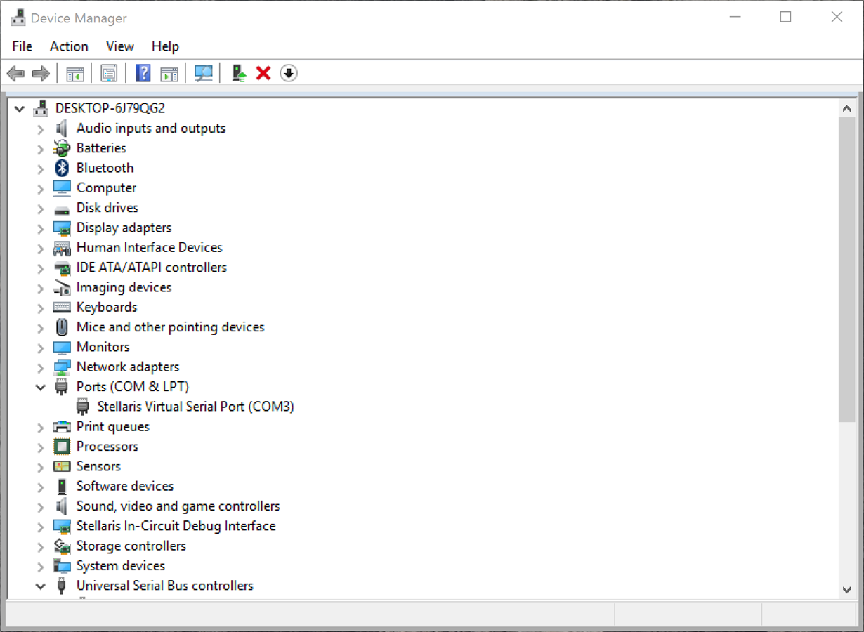

    Once USB Serial Device (COM3) had reappeared, I attempted to install the correct drivers with USB Serial Device (COM3) -> Properties -> Driver -> Update Driver... I selected "Browse my computer for driver software" and selected the location as "C:\Users\Jared Payne\Downloads\stellaris_icdi_drivers" which is the folder extracted from "spmc016a.zip". After agreeing to trust the driver in the pop-up window, the driver appears to have installed successfully.
    The device now appears like this in the manager:
