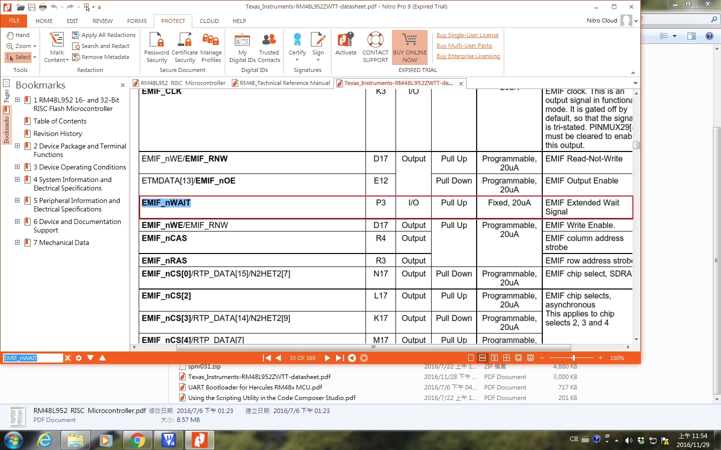

Dear Sir:
on "RM48L952 16- and 32-Bit RISC Flash Microcontroller" , EMIF_nWAIT set to pin P3

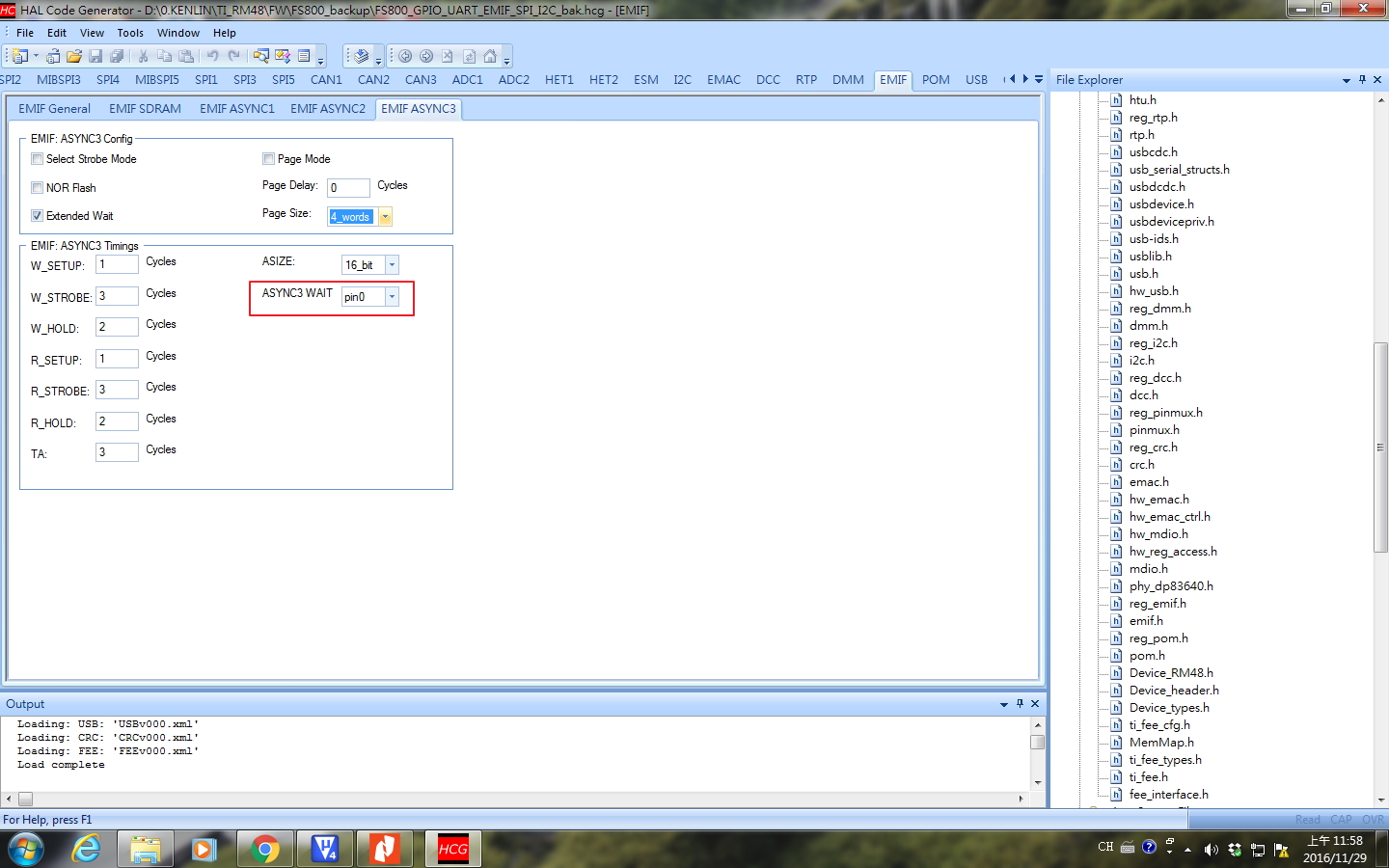

But on HALCoGen , ASYNC3 WAIT can choice pin0 or pin1
Best Regards
ken Lin
  • Ken,
    So I think that only 'pin0' is supported on the device but need to confirm that. I'd say I'm 99% sure of this though so
    you can go with this assumption and try it.
    The EMIF module has two different wait pins, the polarity of each pin is defined on the EMIF_GENERAL tab.
    There you can pick whether EMIF_WAIT[0] pin is active high or active low. Same for EMIF_WAIT[1].
    I think that the datasheet may have an error, where it says EMIF_nWAIT I am fairly sure this should be EMIF_WAIT[0] and you get to define the polarity (active high or low) in the EMIF AWCCR register.
