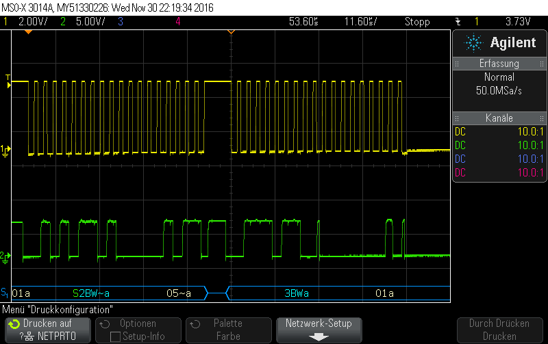

We are trying to send a message from one I2C Module to another on the TM4c123g. Therefore we initialized I2C0 as a Master and I2C1 as a Slave.
We used external pullup resistors.
When the message is received by the Slave the clock stays down and there is no further communication. The first Message sent is adressed to a Slave that doesnt exist. This was made to prove that only received messages cause the problem.
Thanks ;)

int main(void) {
    SysCtlClockSet(SYSCTL_SYSDIV_1|SYSCTL_USE_OSC|SYSCTL_XTAL_16MHZ|SYSCTL_OSC_MAIN);
    InitI2C0();
    InitI2C1();
    IntEnable(INT_I2C1);
    I2CSlaveIntEnableEx(I2C1_BASE,I2C_SLAVE_INT_DATA);
    I2CSlaveEnable(I2C1_BASE);
    I2CSlaveInit(I2C1_BASE,0x3b);
    IntMasterEnable();
    while(1){
        I2CMasterSlaveAddrSet(I2C0_BASE, 0x2b, false);
        I2CMasterDataPut(I2C0_BASE,5);
        I2CMasterControl(I2C0_BASE, I2C_MASTER_CMD_SINGLE_SEND);
        while(I2CMasterBusy(I2C0_BASE));
        I2CMasterSlaveAddrSet(I2C0_BASE, 0x3b, false);
        I2CMasterDataPut(I2C0_BASE,1);
