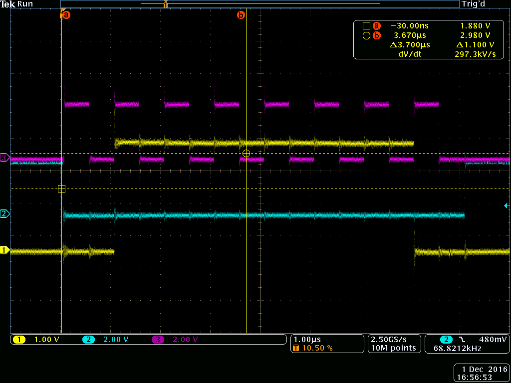

On an RM44LS520, mibSPI1, I am seeing the BITERR flag set although the output data looks perfect on an oscilloscope.
The device has a 120 MHz clock, and a baud rate of 1 MHz.
In the scope shot below, the cyan trace is the enable line, the magenta trace is the clock, and the yellow trace is the data. I am outputting 0x7E.
The data look clean and show no jitter or anomalies. From this very typical trace I see no reason for the BITERR flag to be set.
My question is: has anyone reading this seen similar behavior, and if so, how was it rectified?
