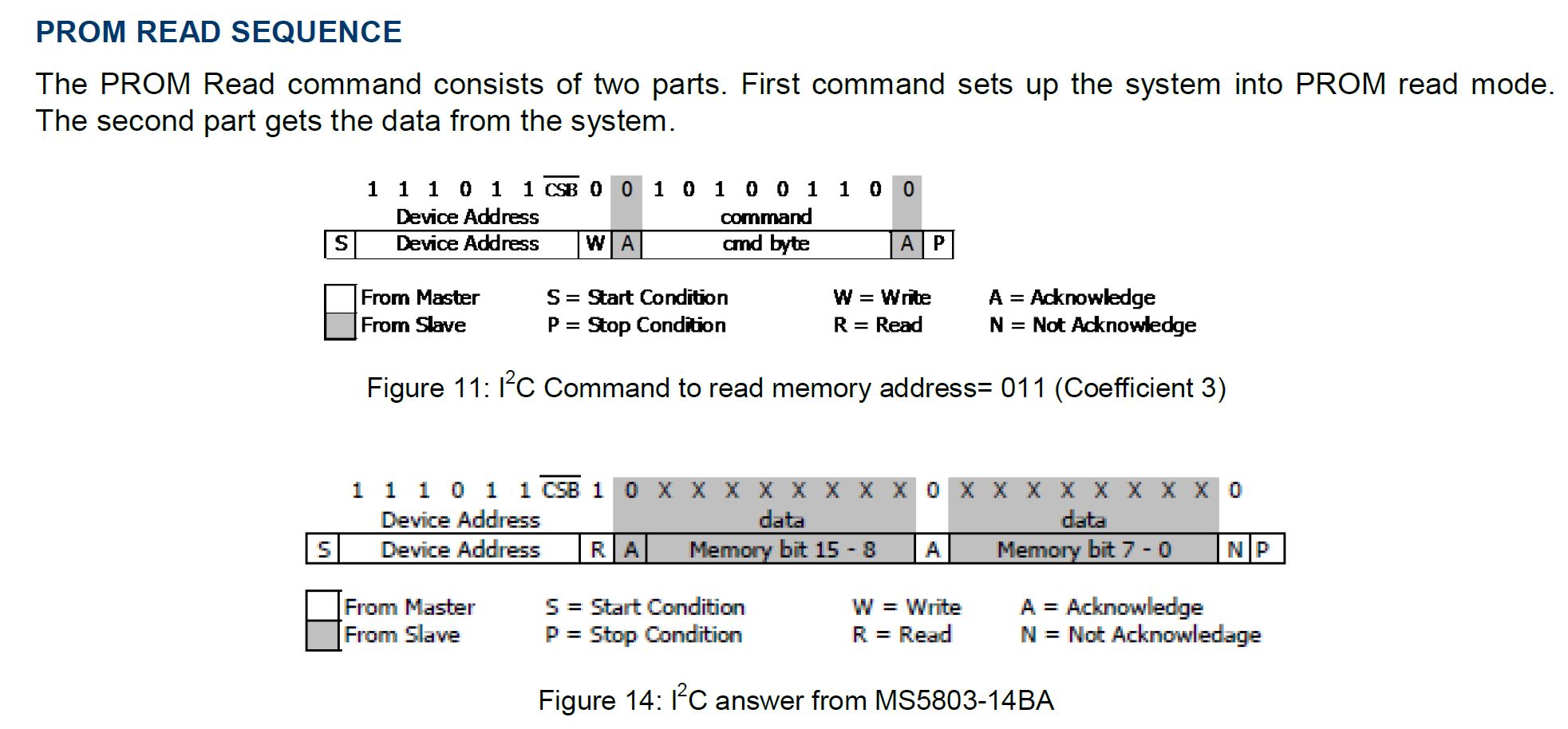

I'm having two (seemingly) related issues getting these devices to communicate. As the data sheet here specifies, I need to retrieve the device coefficients from the PROM before I start polling for readings, and I have written code to begin this first part. My two issues are this: if I step through my code line by line, the first byte I read from I2CMDR is 0 (it should be some 8-bit number) and I get a BUSBSY if I attempt to read the second byte. If I let my code run at full speed instead, I always end up with an I2CMCS of 0x2A (Error, No Ack, Idle) before I even attempt to read the first byte (this is why you see all those delays in my code, I've been trying to find out where that delay needs to be). Below is my full code:

  //send PROM read cmd (0xA0) and offset for C1 (+0) (pressure sensitivity)
  writeByte(0xA0u,(1<<0)|(1<<1));
  delay(20);
  //read and concat two bytes of C1
  byte1 = readByte();
  byte2 = readByte();
  C1 = (byte1<<8)|byte2;

So inside i2cCFG(), my Reset command works fine and is acknowledged. When stepping, the PROM Read command inside getCals() is also acknowledged. However, I'll usually get the MCS errors after initiating the read inside readByte().
Below is a scope capture of the Reset command when stepping:
Below is a scope capture of the PROM read command when stepping:
Finally, below is a scope capture of both commands when run at full speed together. You'll notice that I've forced large delays between commands and even between the first command and the stop condition.
I don't really know why I'm not getting an ACK on the second command, nor why I get a zero in I2CMDR and then an MCS error even if I step through my code.
Any thoughts?
