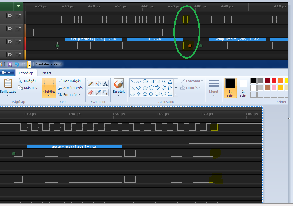

I've analysed the signals on the I2C. See the attached picture below.
In the green circle the written data has been acked by the MPU6050. With the signals below (in paint) there is two problems! The first, that wrong data has been transmitted, one bit is missing (ok, let's say my fault in the code), but the second, that the I2C modul transmitted only 8 CLK cycle, not 9! The last cycle's falling edge is missing! This is very odd. I would say, that there is some problem with the uc's I2C modul. Also the MPU6050 doesn't ACK the write, but is okay, since the uC didn't trasmit the last falling edge.

    There are some advantages to using TM4C123x device. First of all a glitch filter has been implemented which can help with glitches on both SCL and SDA lines. I can see that you are capturing using a Logic Analyzer. What is the threshold for the LA set as?
    Secondly, when restarting the uC, using the debugger use the System Reset and not CPU reset. The former will help clear the I2C status. Second of all when enabling the I2C always perform

    the threshold of the LA is fixed to 1.2V.
    I've added the SysCtlPeripheralReset to my code, now the error bits are cleard. Thank you for the hint! I'll add this for the rest of my code.
    Unfortunelty the problem with the I2C is still present. I've got the same error like on the picture, the 9th CLK cycle is missing from the transmission. Any guess why the I2C modul could fail with 9th cycle?

    I believe there is a glitch on the I2C SCL line that the LA is not able to capture due to its sampling rate. Such glitches can be easily seen on a oscilloscope of 500MHz bandwidth. As I mentioned earlier, the LM4F devices do not have glitch filter which the TM4C devices have. So I would be advise you to
    (a) Switch to a TM4C part or (b) try to find the cause of the glitch and eliminate the same.
