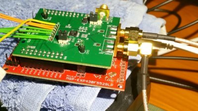

  • Hi Amit
    The TDC7200EVM has 4 rows of 10 pins (in two double banks) and it has been designed to
    connect to the 40 pins on the MSP430F - (it is described here http://www.ti.com/tool/tdc7200evm
    The SPI plus some additional lines to enable the 7200 and interrupt to MCU when data is ready to read
    can be seen soldered on the back of the 7200 and these I connect to the TM4C1294 to save and process
    My question was whether these two connections, one to the 430F and the other as a SPI slave of the
    1294 are going to interfere with each other?
    Tim
