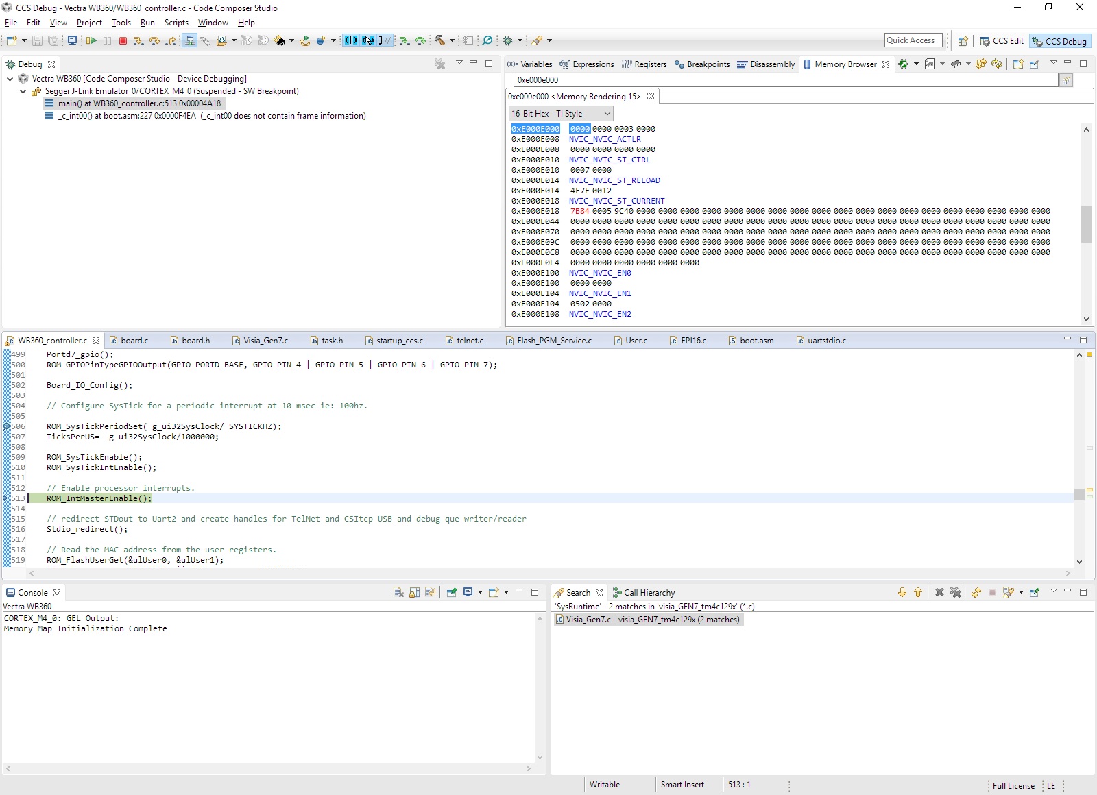

I got a very weird case that I cannot figure out. Please bear with me explaining this.
My project uses TM4C129ENCPDT.
I need to useLwIP. I built my project on a co-worker's exciting project. However, it did not work. The project cannot get IP address, and cannot be found using locator service.  I found another working project. With the same code, the project worked. I discovered that the sysTick was not enabled in the not working project. Stepping through code, I found that the ST_CTRL was cleared after executing ROM_SysTickEnable, and ROM_SYSTickIntEnable. While the same code on the working project does not have this issue. Following is the screen capture of the not working project. Why the ST_CTRL was cleared?
I also tried to change the register in the memory window to enable the timer and the interrupt, however it did not work neither.
thanks
Peng
  • Hello Peng,
    Which exact function stepping causes the SysTick Enable bit to get cleared?
  • BTW, here the ISR table. and the systickhandler. The systickhandler never got executed.

  • Amit,
    It was still in the main function.
    Peng

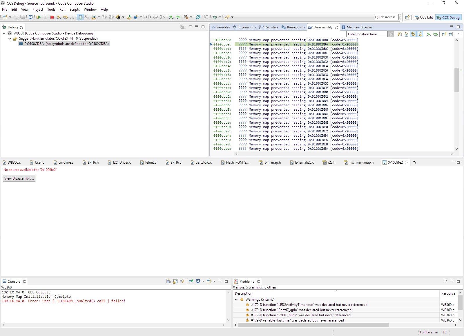

  • Hello Peng
    If the SysTick is not counting then of course it will not go to the interrupt handler. I would suggest that you step through the SysTick functions to see what is causing the SysTick to get disabled in the first place.
  • Amit,
    ROM_SysTickEnable and ROM_SysTickIntEnable are functions in the ROM. Do you know how to step through it? I could not do it.
    I know the counter is counting because the STCURRENT register changes everything when I pause the program

  • I'm not familiar with the CCS yet. But I think it may be something that is project setup related. The same exact code works on the other project.

  • Amit,
    I found that it is related to the project setup. The processor was not set to the 129ENCPDT. Once I fix this, it register settings are correct now.
    But it still does not work correctly, the systick isr was not called. So I think it may related to startup_ccs.c. It looks like that the startup_ccs.c was not linked to the project.
    Can you point me to how to setup the startup_ccs?
    thanks
    Peng

    Anyway, while I dug into this. I found that the processor went to some wild address 0x0100cdba. Please see attached screen capture.
    I searched the map file. Did not find an address that could be in that location. I kept trying this, later I found that if I enable the internal EEPROM0 using SysCtlPeripheralEnable(SYSCTL_PERIPH_EEPROM0), the project worked fine, no crash at all. I did not find the root cause for this. Since the project is on a tight schedule. I moved forward with this workaround. However, I know that if I don’t understand the root cause, it could come back again.  I need help from Ti to help me find the root cause.

  • Hello Peng
    0x0100cdba is the ROM Map region of the uC and is not mapped as the debug symbols in this region are not provided.
    Without enabling the EEPROM, any access to the EEPROM register address space will create a bus fault.

    Do you know which ROM function is in that address range? It will be easier to find out the crashing reason with the function address information. I understand that any access to EEPROM register will create a bus fault when the EEPROM is not enabled. That's why I commented out those EEPROM access code. I'll look into if there's any other place access the EEPROM register.
    Could it be possible that the crash was related to some interrupts?

  • Hello Peng,
    Thanks for the version info. That helps rule out any errata. As for the interrupts, I cannot say for sure as to how the application code of yours is structured.

  • OK. I was following the the previous question of "Do you know which ROM function is in that address range?(0x0100cbda) " .
    Is it possible to find out what function is located at 0x0100cbda. This way, I can figure who called that function, or what caused the function to be called.

  • Hello Peng,
    ROM data is TI proprietary information and cannot be shared. However to isolate the root cause can you please run the experiments listed out in my previous post?
