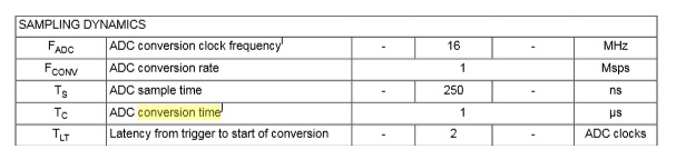

  • According to datasheet, if I set system clock 16 Mhz then only for 1msps setting, conversion time will be 1us.
    What will be conversion time if I set System clock 40 Mhz, 1msps setting..?? OR
    What will be conversion time if I set System clock 80 Mhz, 1msps setting..??
  • Hello Krishnat,
    Please top adding the same message on every post that you can find. If you have a real question here, open a new post.
