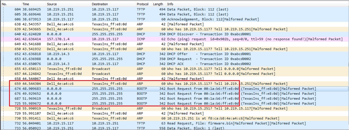

    user4461578 said:
    then enter the bootloader, I check the code excute the Boopt send function by led in bootloader, but I cannot find any BOOTP in wireshark.
    I am able to see the BOOTP packets on wireshark. Look at the image below. This screenshot shows packets from the bootloader completing the firmware update (at the top of the screenshot, with TFTP packets) to the application getting an IP address (in the middle with ARP and DHCP packets) and then the bootloader starting the firmware update (with the BOOTP  and TFTP packets).
    I have used the bootloader example "./examples/boards/dk-tm4c129x/boot_emac_flash" (same as the one you used) and the app "./examples/boards/dk-tm4c129x/boot_demo_flash" from TivaWare v 2.1.3.156 on a DK-TM4C129X board.
    Sai
    Update: Looks like your application is based on the TivaWare Example "./examples/boards/dk-tm4c129x/boot_demo_emac_flash" as your code has the function "SoftwareUpdateBegin". The main difference between both the applications is in the way the user triggers Software Update. "boot_demo_flash" uses a touch on the LCD panel and "boot_demo_emac_flash" uses magic packet from "LM Flash programmer". Once the software update is triggered by the user, both the applications will jump to Bootloader, if the default define values are not modified.
