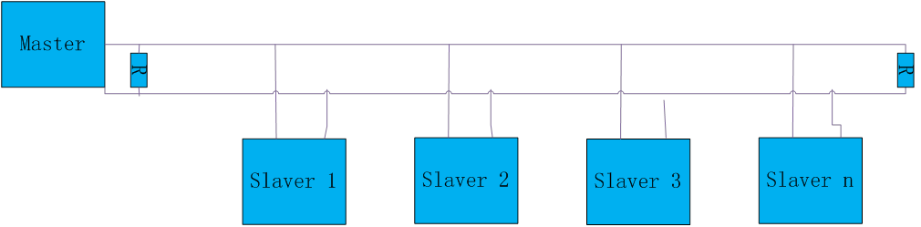

Below is our CAN network,  Master is TM4C1294, 120MHz. The main job is to convert UART and CAN to Ethernet. Slaver is TM4C1230, 80Mhz. focus on convert UART to CAN.
The longest cable length is 100 meter, the most slaves up to 10-15 unit.  500kbps or step down data rate to ensure communication is successful.

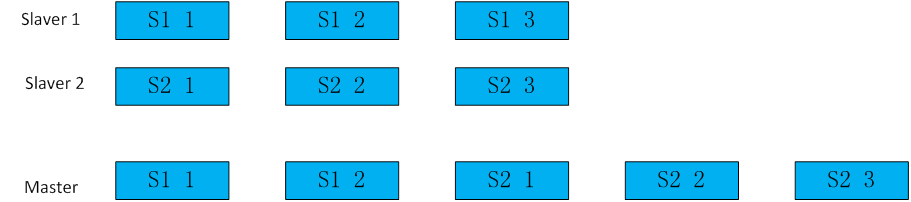

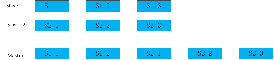

Slaver 1 and Slaver 2 send data at 8bit according CAN requirement, but the package make up by many bytes. So it separate to send and then recombine. From above picture, you can see S1_3 is lost, which finally lead the whole package to be wrong. Do you have any suggestion to avoid?

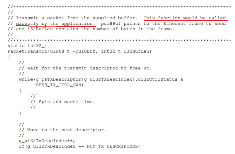

a. It current use PacketTransmit() from bl_emac.c, my understanding is to send one package by DMA. But why it must define NUM_TX_DESCRIPTORS to 8? 8 buffer?
b. Another way is to call tivaif_transmit() in tiva-tm4c129.c, is it a chained mode transmission?
My question is what's the difference on above two method? and how to max the speed of convert CAN to Ethernet while TM1294 will be dead once there are many times UART interruption.

    2. Typically the approach would be to have the first packet with a header stating a start of frame and expected data bytes in the fragmented packets to follow. Each subsequent packet to have an intermediate header followed by remaining packets and the last packet to have end of frame and remaining data bytes of the packet. This will help identify the packet missing. Also additionally checksum can be used
    3. PacketTransmit in bl_emac. is for the boot loader. You must use the tivaif_transmit for application usage.

    For question 3, one more confusion. Code example and 10.3 section of TivaWare user guide use PacketTransmit() and tell us it can be called directly by the application.
    Is the reason because of lack error checking and recovery code? So it should call tivaif_transmit() at application code.
    http://www.ti.com/lit/ug/spmu298d/spmu298d.pdf?keyMatch=tivaware%20user%20guide&tisearch=Search-EN-Everything

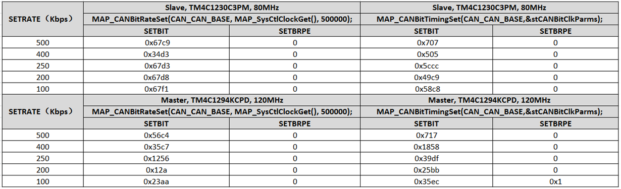

    1. The test method is master work at 500kbps firstly, Slave keep at scan mode, then make decision whether jump to next lower data rate by judging LEC bit of CAN Status register, or keep at current data rate if CAN status RXOK is "1".
    2. The register setting as below table. One way is set by MAP_CANBitRateSet() function. The farthest cable length is shorter than bittiming mode when running at 500kbps. Another way is setting MAP_CANBitTimingSet() function, but it's working OK when master at 500kbps and slave is 200kbps .
    Could you kindly have a double check below our register setting or give your recommended number? Thanks.

    The code example shown is for using the Etherent controller in native format. It does not mean that the IP address is acquired. How is the IP address being acquired over the network?

    1. Can we extend to 100 meter target range at 500Kbps by MAP_CANBitRateSet? Currently it's working well at ~70 meter on network cable at 500K. Which parameter is the most important factor affect cable length? external transceiver? cable type?
    2. Don't put slave on CAN bus, then master acquire bus error because no ACK received. Mater can recover itself at 1ms or can't recover at a long time after mount slaves. Is there any function which can be called to help master recover more quickly once there CAN bus error detected( bus off, EPASS)?
    3. Can you kindly give more description about DMA Descriptors? It define UM_TX_DESCRIPTORS =8 at tivaif_transmit(), we are not sure that
    a, every Descriptors is a complete message
    b, or send out all Descriptors once enable DMA one time
    Is there any other method to improve Ethernet transmit efficiency?Thanks a lot.
  • Hello Daniel
    The cable length is an important parameter for the bit rate. As for error recovery it is very specific to the type of error being seen on the bus.
    The Ethernet being used in a raw format is something I am not familiar with. We have tested the same with lwIP and it seems to perform based on the network load.

    For question 2, in nterrupt function, we get bus status by call ui32Status = CANStatusGet(CAN0_BASE, CAN_STS_CONTROL);
    (1) power on master, ui32Status=0x03;
    (2) then ui32Status=0x43;
    (3) then ui32Status=0x63;
    (4) 1ms after mount slave, ui32Status=0x50;
    (5) Sometimes, can' t be recovered. ui32Status=0x63; and bus off
    In order to don't waste 1ms to wait or can't be recovered. Which function can be called to speed up master recover more quickly? Thanks.
  • Hello Daniel,
    The Bus Off condition can only be recovered when there are a certain number of messages successfully transmitted and sensed by the controller sending the message. There is no short cut to the same.
