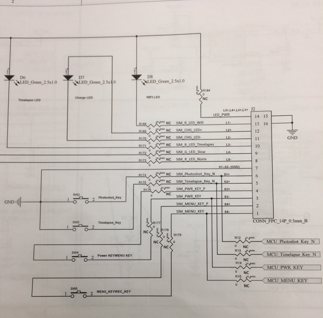

  • Hi Amit
    I measured my switch leg but it just 0.04V, I thought it has some problems, I'm still finding it. Thanks for the response.
  • Hello Yang,
    What about the Pull Up resistance on the switch when the key press is done? Can you please share the schematics of the external switch?
  • Hi Amit,
    I don't really understand the first question, but I think maybe the problem is system doesn't offer enough voltage to the switch. I just solved the problem by adding a circuit with 10K resistance and connect to the sys 3.3V. Finally it works!
    I don't have the schematics of the switch, there is only one type switch in my office.
  • Hello Yang
    So you could have drawn the circuit on a paper and attached the snapshot. As I thought there were missing resistors.
  • Hello Amit,
    It's the circuit. I'm now using SW2(PD4).
  • Hello Yang
    So R174 needed to be populated and the connector pin 6 needs to have a 3.3V. Only then the MCU_Photoshot_Key_N will be High (R12 needs to be populated as well) when the key is not pressed and will be low when the key is pressed.
  • Amit,
    Poster does have the pin configured as an input, and the pad set as weak pull up:
    GPIOPadConfigSet(GPIO_PORTB_BASE, GPIO_PIN_1, GPIO_STRENGTH_2MA, GPIO_PIN_TYPE_STD_WPU);
    Hence, provided that both R12 and R174 are populated, there is no need for a 3V3 line on J2-6 - the internal pull up will take care of keeping the signal high when the button is not pressed. Apparently the connector is to be used as an external switch.
    Bruno
  • Hello Bruno,
    Yes, indeed. I did overlook the point when the schematic was not shown. With NC's in the schematic there is not much that can be thought other than the circuit is not complete.
