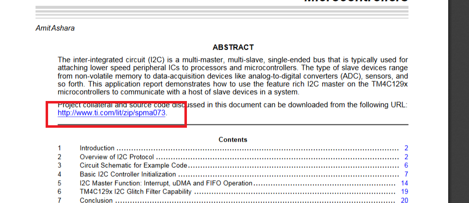

  • Hello Peter
    Can you please refer to the following Technical Application Note mentioned below. The SW collateral along with the application note should be able to perform the 2 byte transfer with NAK
    www.ti.com/.../spma073.pdf
    In our testing of the I2C we have never seen such an issue. Also is the issue only with 2 bytes or any other configuration of transfer?
    Hi Amit,
    I've read that application note but it didn't talk about using the FIFO without interrupts.
    Which part of my code needs changing to align with the app notes?
    What do you mean by SW collateral?

  • Hello Peter
    The example code uses FIFO with interrupts.
