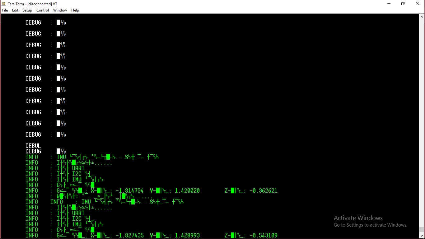

Hi all,
I am using a tiva C controller, TM4C123GH6PM, for my IMU application. I want to print my debug message through UART. My code is below. Function description:
ConfigUART: Configure UART
UARTIntHandler: Interrupt handler. In this function, I check for UART message receiving and transmitting interrupt. If there is a transmitting interrupt, it means that the previous byte is transmitted, I will check if there is any byte in my transmitting buffer, UARTTXBuffer. If yes, transmit that byte, if no, annouce the upper layer that transmitting is done.
UARTSend: Put bytes in to buffer and send the first byte using UARTCharPutNonBlocking to create an interrupt.

I have another c file for definition of log functions:
Log.c
void PrintDebug(const char *string, ...)
	volatile char txBuf[100];
    DEBUG_HEADER();
    va_list arg;
    va_start(arg, string);
    int len = vsprintf((char *) txBuf, string, arg);
    va_end(arg);
    UARTSend((uint8_t *) txBuf, len);
    COLOR_ENDL();
My question is that when I print message through UART, I get the flowing issue. My baudrate in my terminal and MCU is match.
I have another question. In my PrintDebug function, I have use a static array txBuf[100]. I use it with function vsprintf to create a string to send. But that will lead to memory problem. How can I avoid that?
  • If indeed you've "matched baud rates" then you must have unmatched "bit numbers" and/or parity disagreement. (many of your received characters have the msbit set.)
  • Hi cb1_mobile,
    My problem is fixed, I have unmatched "bit numbers". I have another question as above: "In my PrintDebug function, I have use a static array txBuf[100]. I use it with function vsprintf to create a string to send. But that will lead to memory problem. How can I avoid that?"
