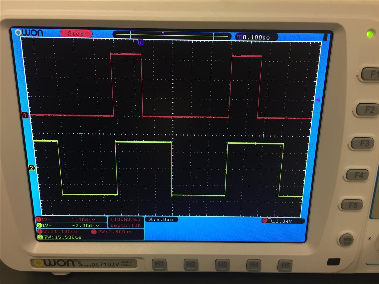

The code below is designed to generate a 25 kHz PWM signal (T=40us) but is observed with a period of 31.1us.
Code & Scope Capture

See below for measured results, Ch1(Red): PWM3, Ch2(Yellow): PWM2 -
Question
Why do I see a period of 31us, not 40us?

  • Have you noted not only frequency error - but if your scope cap is to be believed - PWM2 (red) is half the duty cycle of PWM3(yel).   (You've likely transposed - code shows the opposite!)
    I can't spot any code error - and you've done a nice job in detailing your calculations. (Bravo that)
    Might your System Clock be off? You can cause a low impedance and accurate replica of the System Clock to be output upon a Timer pin. I'd be suspicious of your xtal, xtal caps, xtal routing. (assumes homebuilt pcb - untrue for vendor board)

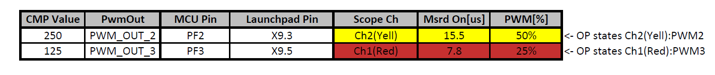

  • Probably could have displayed this with more clarity :) -
    Original:  "Ch1(Red): PWM3, Ch2(Yellow): PWM2"
    Cleaner:
    • Ch1 (Red) = PWM3
    • Ch2 (Yellow) = PWM2
    Correction:  "PWM2 (red) is half the duty cycle of PWM3(yel)."
    • PWM2 is yellow, you misread. My apologies!
    Here is a cleaner table:
    Also importantly to note, I am using the 1294's Launchpad (EK-TM4C1294XL), so this is observed on a factory board! :)

    • My measurements are correct (PWM2_ON= 50%, PWM3_ON=25%)

  • Do you know your 'scope is correct?

    First monitor the System Clock output on the SYSCLKOUT pin with a known divider to check if the system clock is as expected.

    True enough, and it's rare that an oscilloscope would be off, rarer still that much. Still if the SW must be correct then the measurement technique should be verified.verifying the operating frequency as pointed out is an obvious step.
    Robert
