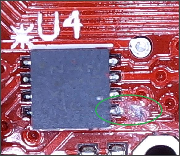

I am in the process of debugging some PWM code, see here -

Now my Launchpad hangs, and both Code Composer and LM Flash both cannot access the Launchpad!
  • CCS Report: "Error connecting to the target. Frequency is out of range"
  • LM Flash Report: "**ERROR**: Unable to find a target!

  • Amit, thank you!
    I used the following to correct this:
    For convenience for future readers, here is the procedure from Sec 5.3.1 (direct copy):
    • Start the LMFlashProgrammer utility and go to the tab “Other Utilities”
    • Select the radio button in front of “Fury, DustDevil, TM4C123 and TM4C129 Classes”
    • Power down the board containing the locked microcontroller
    • Power up the board, while holding down the reset. The reset must remain pressed unless instructed by the LMFlashProgrammer to be released
    • Press the “Unlock” button in LMFlashProgrammer. Press “Yes” in the pop up message box and then press “OK” in the information message box
    • After some time, a pop up Information box will ask to release the reset. Release the reset and press OK in LMFlashProgrammer utility
    • Finally, the board must be power cycled. At the end of this step, the TM4C12x microcontroller should return to its factory state

  • The following code produces the same error state (truncated form of OP):
    On the EK-TM4C1294XL Pin PQ4 of the TM4C1294NCPDT is connected to U4 pin 5. The referenced thread contains the comment:
    You must also cut trace from U4 pin 5 if you use a EK_TM4C1294XL eval board or you will get suddenly a message that the JTAG debugger could not connect.
    Perhaps U4 pin 5, which is an open collector output on U4 TPS2052B Power-Distribution Switch, is shorting the TM4C1294NCPDT  DIVSCLK output on pin PQ4?
  • Oh my, cutting the U4.5 trace immediately corrected the problem. See below for the cut made -
    A bit embarrassing that I missed such an obvious config and debug step, my strong apologies. Thank you for the help!!
    Status
    • Code outputs SysClk to PQ4
    • Code runs through and does not hang, maintaining JTAG connection
    Thank you again!
