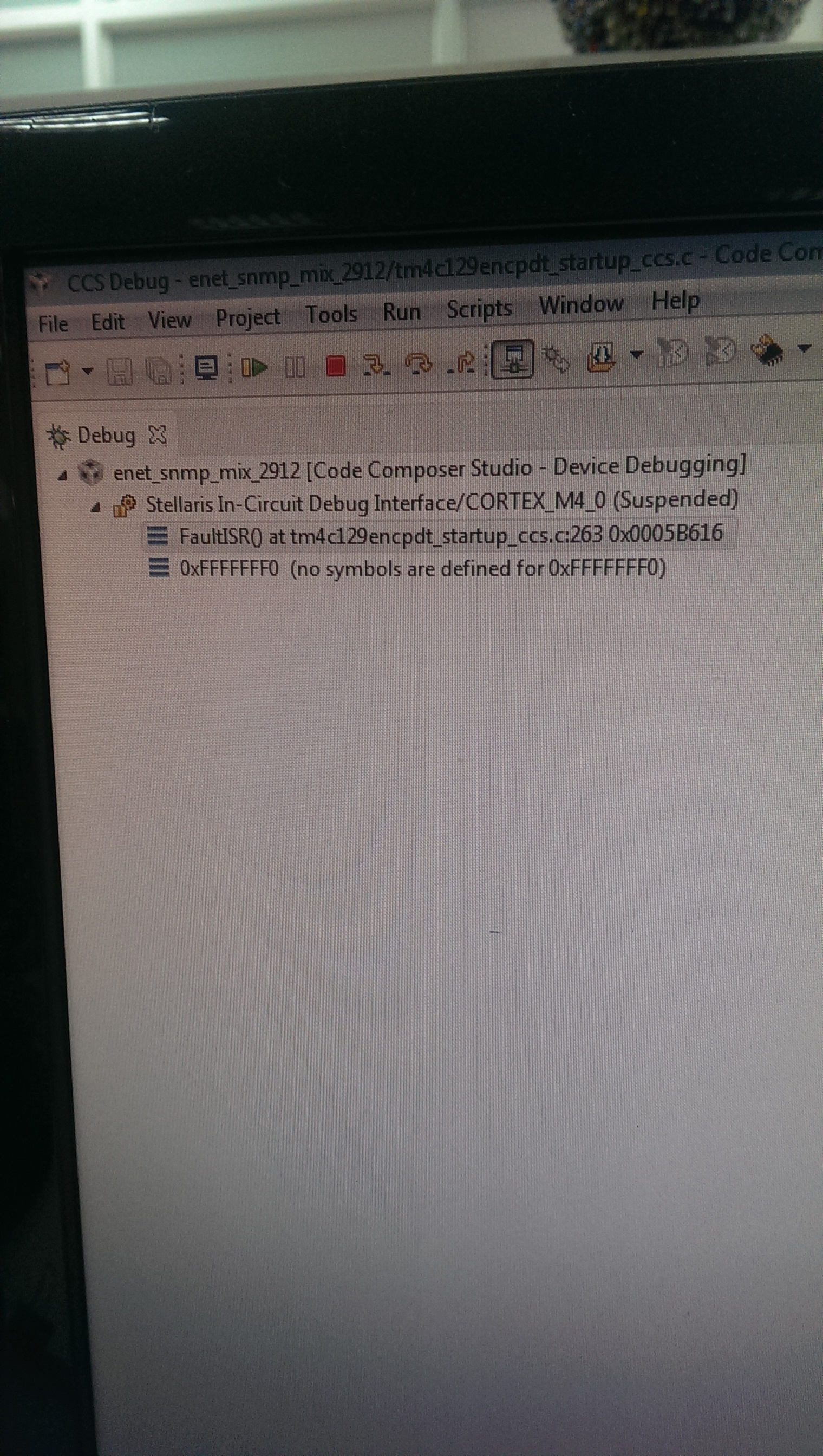

    When you have interrupt faults like that, please use stack frames history - these are inside debug window, upper left; when your program stops at a line, and shows that in debug window, press on the line below that - that is the stack frame which generated the fault; in code window shows the code line with problem. And in asm window shows the particular code when stopped.
  • Hi Petries
    I did the same thing as you mentioned. It pointed to memory that can't read.
    Thao
    And the line below the second one? You can play with all lines listed in debug window. Please post a picture of debug window.
    You should be sure to have the symbol DEBUG defined in predefined symbols tab in compiler settings to have all memory regions with debug symbols. The only exceptions: if you have used ROM_ prefix for some functions, then remove that prefis and use the driverlib defined function and the second one is if try to build a release version - then revert to debug version.

    These are some pictures of debug window when i get this error.
    Thao
    Your picture shows "FaultISR()at tm4c129encpdt_startup_ccs.c:263 0x0005B616" which shoud be read as this: at line 263 in tm4c129encpdt_startup_ccs.c you have the problem.

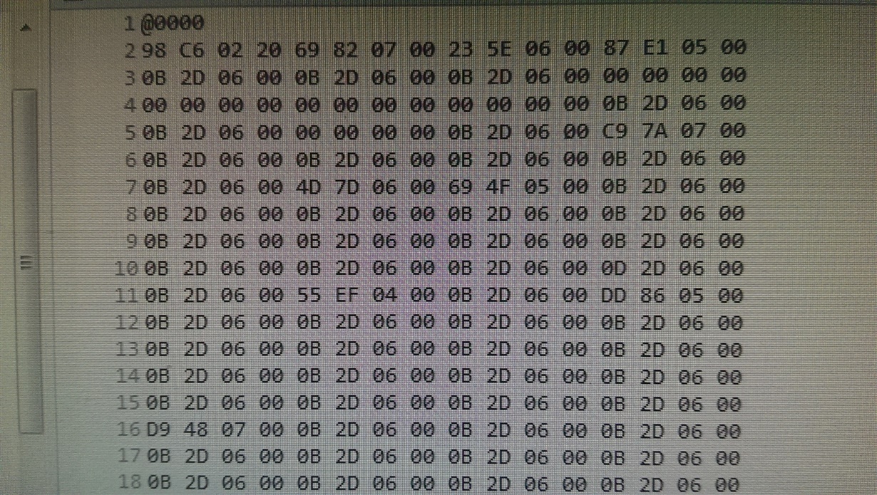

    Since the name is not similar with that provided by Tiva driverlib, you should inspect that line in your file. The original Tiva file does not show anything special. If your file is the same as the original, then there are several steps to follow and inspect to get further info:
    a) generate a map file and a binary file (you must have that already). Open the binary file with an hex editor and inspect the first eight bytes from address 0x0. The first four bytes are the stack pointer location and the next four are the ResetISR address, which should be odd number. If even, then this is the cause of your problem(take care these are shown in little endian).
    b) inspect the map file and locate address 0x0005B616 and see what routine is placed there.
    c) How go further depends on the results from previous points.

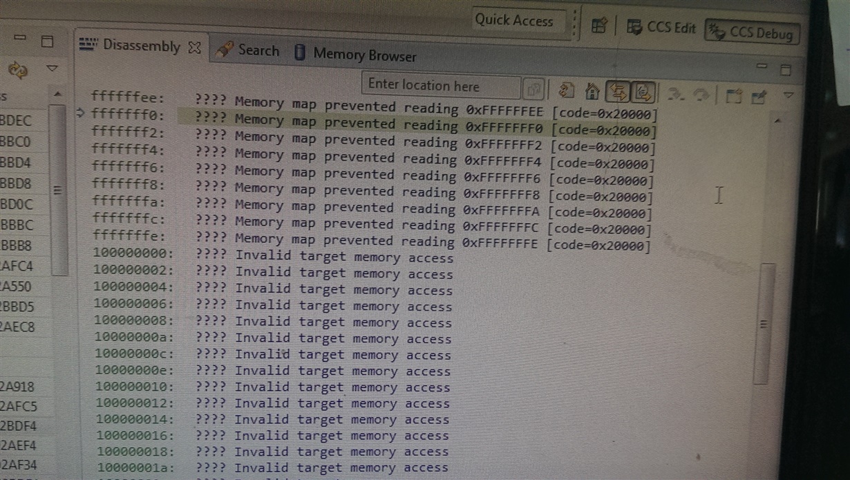

  • Hi Petrei
    I added DEBUG in predefined symbol but I still get this error.
    The second imagine attached is for line 0xFFFFFFF0(no symboys are defined for 0xFFFFFFF0) in debug window.
    Thao
    You did not answered my questions a) and b) so it is impossible to think further to your problem.
  • Hi Petrei
    I followed your guide  and this is the result:
    a,  In binary file, the first four bytes is even, the next four bytes is odd.
    b, In the map file, at the fault address it is FaultISR().
    Does my program stack overflow. I had increased   stack size 2 times in Properites/Build/ARM Linker/Basic Options/Set C system stack size, but it is still even.
    This imagine is binary file.
    Thao
    Sorry to say, but your claims about a) and b) are not sustained by your picture. I do not know what tool you used, but suggest to use Total Commander (useful also for other operations on computer) to view the content of .bin file (select the .bin file and press F3 and 3). The address should be also displayed.
    The stack address should be even; only the ResetISR address in interrupt vectors should be odd.
    Also seems you run a release version of your program - try to run a debug version and before running set a breakpoint at main. Then after loading the program this will stop at main. After that run again and see where your program stops. Also in my post on Dec. 20, I suggested to set a watchpoint at variable _stack to see your stack size. Keep in mind the stack size should be set from compiler settings.
    If you use some pre-compiled library taken from other sources (like git) take into account these may have bugs or compiled without correct settings. Amit suggested you build a separate library - you did not confirmed that. The unusual thing is this library contains startup_ccs.c and I wonder why - there are some modifications of the original provided by TI? Such file should not be included into library since it must be available for modifications of vector interrupts.
