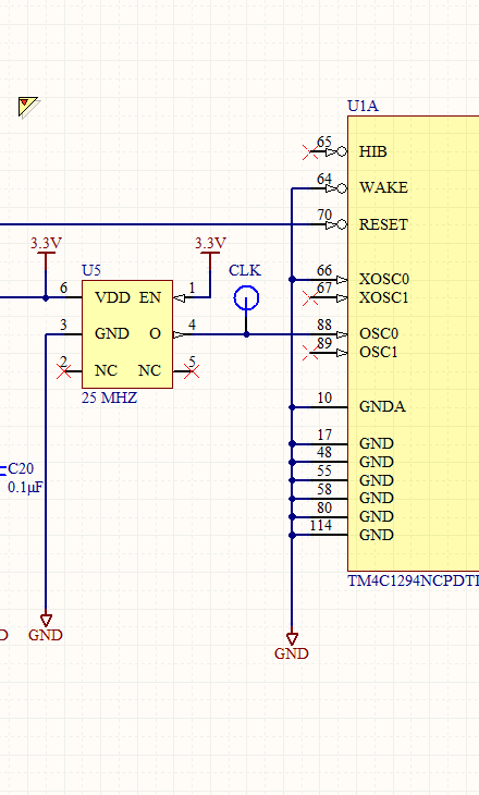

Hi all,
I'm developing on a custom board that utilizes a TM4C1294NCPDT microcontroller.
My debugging environment is as follows:
- I use the debugging portion of EK-TM4C1294XL Launchpad for programming, debugging and flashing code onto my board
- Code Composer Studio v6
- LM Flash Programming
On my board, I have 6 circuits that convert optical PWM signals into a 10 KHz PWM electrical signals which go into both Timer A and B of all 6 timers (timer0 to timer5).
I noticed recently that using more than 3 inputs at a time (3 timers) decreases the range at which the timers can sense. Using less than 3 inputs at a time is shown to work perfectly fine at 1% to 99% within a reasonable tolerance. When I use 3 or more, then pushing any of the 3 inputs above 93% duty cycle will cause one of the 3 timers (slightly random) to display garbage. I am assuming at this point that the this is mainly due to the timers now essentially interrupting each other causing one the edge time capture registers to capture garbage. Unfortunately, I couldn't find any relevant information in the manual, and I was not able to find a similar regarding my issue.
Any help in solving this problem is greatly appreciated
Cheers,
Stephen B
Relevant files are attached (I attached the wrong configuration file, I will update when I get access to my work laptop. The handler file should be the correct one).

  • Hello Stephen
    What is the system clock being configured as?
  • Hi Amit,
    Apologies for the late response.
    My system clock is set via:
        // Run from the PLL at 120 MHz.
        g_ui32SysClock = MAP_SysCtlClockFreqSet((SYSCTL_XTAL_25MHZ | SYSCTL_OSC_MAIN | SYSCTL_USE_PLL | SYSCTL_CFG_VCO_480), 120000000);
    The board clock uses the following schematic:
    Oscillator part number: XLH735025.000000X
    Cheers,
    Stephen
