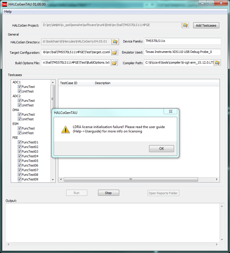

Dear Ladies and Gentlemen,
we have issues executing test with the HALCoGen TAU v01.00.00. The warning reports that the LDRA license initialization failed, but when starting LDRAunit-TI-Qual v9.4.3 the license is correctly read from the license-server.
Any ideas what I can do?
The TAU is running with admin-privileges and I already tried deleting the ini-files in "c:\ProgramData\LDRA\".
  • Hi Erik,
    I have forwarded your question to our software team that developed the CSP so that they can have a look. One easy thing to consider, though, is if you installed the CSP and associated files to the default locations or if you chose another location to which to install them? This might cause issues if something were hard coded (which is always a bad idea but happens from time to time). If you don't see any response from our experts in a timely manner, please let me know. Thanks!
  • We could solve the issue. The problem was a old perl version. Updating to the newest ActivePerl works.
