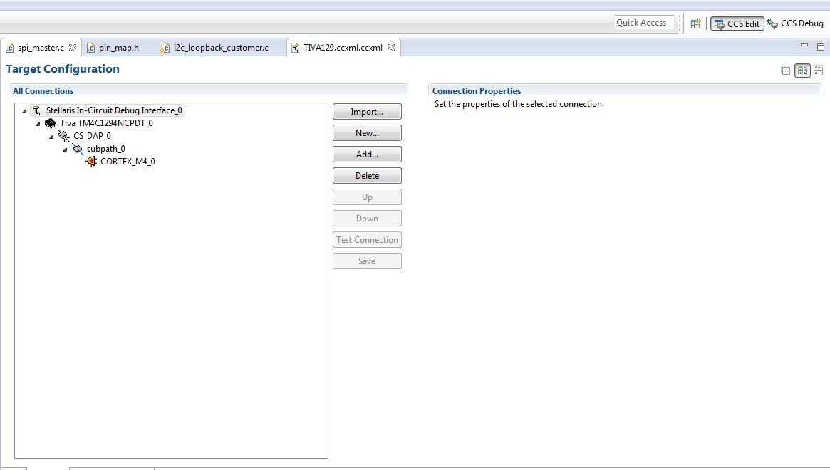

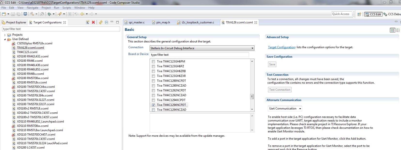

  • In CCS Edit, go to View->Target Configuration. From here go look for your the target configuration that assoicate with the project. Double-click on the target configuration, i.e. xyz.ccxml then you will see the screenshot like below. At the upper right under the Advanced Setup, click the Target Configuration link then it will bring you to the screenshot that I posted earlier.
    You will then see below.
    Click on the CORTEX_M4_0 then you will see the screenshot that I posted in my earlier reply. Try to reduce the JTAG speed and see if it works.
