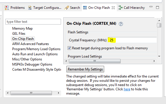

  • Hi Lucas,
    Not sure, but please check that the crystal frequency is correct in the On-Chip Flash tab. Once you connect to the device, select "Tools"->"On-chip Flash". Check that the crystal frequency is set to 25MHz as shown below:
    Then select "Remember My Settings" so this will be come the new default for you.
  • I can not find the exact View you showed, but there were similar settings on
    Project - Properties - Debug - Flash Settings - Crystal Frequency
    It was set to 8MHz, changed to 25MHz, no effect. Same error remains.

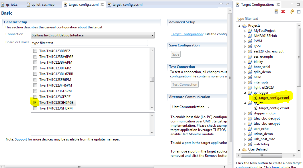

  • I think what happened is that you imported the example "qs-logger" from a "TM4C123" directory. If you then used the "target_config.ccxml" file that is associated with that project, it is for a TM4C123G part. If programming an EK-TM4C129XL Launchpad, you need to use a TM4C1294 target configuration. To check on your machine, double click the "target_config.ccxml" file you used to launch the connection and it will open in the file window. There you can see which device it is selecting. Below is a picture of using the wrong configuration. When I used the wrong configuration to program "qs-logger" into an  EK-TM4C129XL Launchpad, I got the same error you reported.
  • Thanks for the replies. Checked target config, was Stellaris ICDI and TM4C1294NCPDT.
