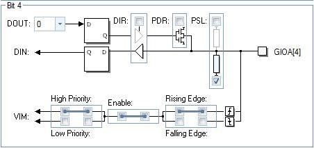

HALCOGEN CODE GENERATOR: (what changes i did)
1) In Bit-4
a) pull down is enabled
b) Rising edge is enabled
c) interrupt is enabled

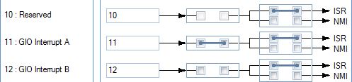

d) high priority is enabled
2) In VIM channel 0-31
a) i enabled the 11th channel.
after this changes i generate the code.

i attached the images also.
vimchannel image:
