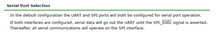

    What is the XBEE pin 17 connected to? If it is left floating, it might cause the XBEE to use SPI instead of UART.
  • Pin 17 is floating on the PCB, but through the XCTU configuration we have it internally pulled up.
  • It might be worth checking the level on that pin. Internal pull-ups can be pretty weak. The symptoms you are seeing are consistent with an indeterminate level on the pin that defines the XBEE serial interface.
