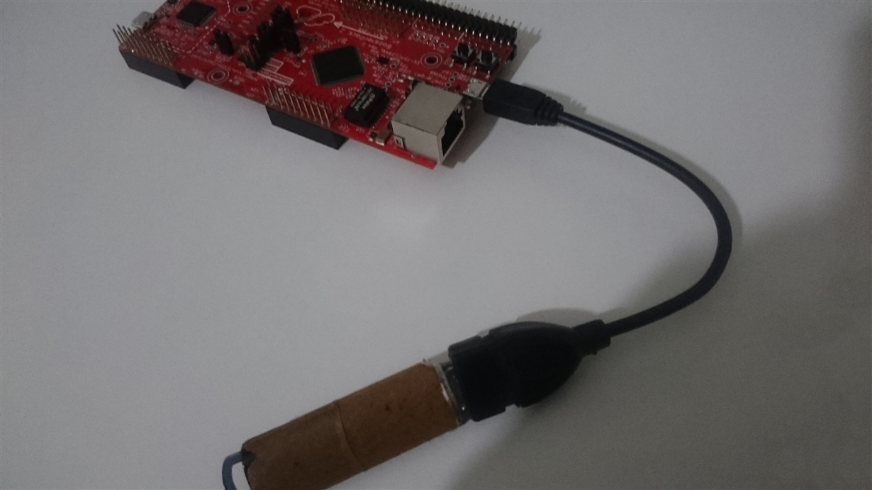

So...I was trying to write a text file on my Tiva device (EK-TM4C1294XL), after a couple of time trying to understand how the usb_host_msc works, I decided to create a function that writes some text file for logging purposes. Everything was running smooth so far, except that in the beginning I was only printing some random strings.
Then I decided to make a loop to write the string multiple times in the file. Flashed the new code, didn't work the way I expected, tried to modify the code and that was when the compiler refused to load the program on my device. I tried a couple of times until I realized the MCU core was very, very hot, and obviously, dead ;-;
This was the function I was executing at the time:

Also I'm attaching a image that shows how the USB stick connection was made. How that happened? I was planning to use the USB stick in the TM4C123, but now I'm afraid of killing my other Tiva as well...not to mention that some hardware modifications is required for that device.
  • Hello Helder. Your photo does not show the EK-TM4C123GXL but the EK-TM4C1294XL instead. Need to ask you something: Is the area/room/office that you are working with the Launchpad anti-static protected? Is your floor wooden/cement/neutral polymer OR covered with artificial imitations of these materials? Maybe is not your code but the static in the area that fried your Mx core. How to you supply power to your board. Are the jumpers for power supply correctly set?
    John
    P.S. Seems that you power the USB flash-stick from Launchpad. Does your power source support the needed mAmperes?
  • Oh, I'm sorry, it is the TM4C1294 that I burned up (not sure I can change that now). The place I work is not anti-static protected, but the floor is wooden. I supplied power via the ICDI using the computer USB port, which I believe that supports at least 500 mA.

  • Helder Sales said:
    ...TM4C1294 that I burned up
    Feel your pain - yet do NOT be so quick to conclude that the device is (truly) dead!   Firm/I have recovered multiple MCUs (from multiple makers) which have suffered (brief) over-heated "episodes."  (Note: this is NOT to suggest that you target this MCU for "human implantation or deep space" - it may be suitable (still) for (much) of your continued development.)
    I'd suggest that you power that board via a Lab Supply - which can "current-limit" - and power the MCU board with "nothing" externally connected.    You may wish to set the supply's current limit to 10% over the board's rating.   If the board draws current - substantially beyond its spec - that then proves a far better indicator of board's (life or death.)   I'd give your board 60:40 odds of (not) having died.   (unless that over-heat condition - passed un-noted -  for a LONG time.)
    As you appear "locked out" now - the LMI Flash Programmer provides a method to (attempt) to restore the device to operation - yet I'd launch that attempt only after the current measurement indicates "board in coma" rather than death.
    Note that while the USB spec lists 500mA - that's not always fully reached (really - who is going to measure) and your board & its external device may draw "too much current" upon power-up/connect.
    During development - most always a "real" Lab Supply - properly voltage & current limited - can prevent such misfortune.   (and will provide an excellent "display" of typical board current)    Choosing connection "ease" (PC) - over "board health & current monitoring" (Lab Supply) - has a downside as you've (painfully) discovered...

    I've tried that (thanks for the tip), though I don't have any way to limit the current (but I read 67 mA  from the multimeter through the JP2). It worked! BUT...it seems that the board is damaged, I tried to run some examples like Timer and Blinky, and the on-board LEDs (except power LED) not light up anymore, only the serial comm was working and the Timer0.
    Oh man, I'm not confident enough to use a USB stick again in any board...not without a lab power supply or some means  of monitoring the current (multimeter not always works, sometimes the UART doesn't function properly with it).
  • Hi Helder,
    The on-board TPS regulator has current-limit. Since you just said you can connect to the target and run some code, i..e serial comm then I don't think the board is dead, at least not totally. Can you please check on the scope of the GPIO pins (PN0, PN1, PF0, PF4) that drive the LEDs to see if the LED diodes are bad or the GPIO pins are bad?
    PF0 and PF4 is functioning normally, but PN0 and PN1 is stuck at 1.95 V. I guess I'll have to sweep the entire board to see what's left intact.

    You might want to also check if the LEDs are burned out. 1.95V is supposed high enough to turn them ON. Looking at the schematic there is 330ohm series resistor to protect the LED. So not quite sure why/if they would burn out.
    Looking at your code again, I don't really spot anything wrong. Can you rerun your code again? Are you sure Cmd_write() was the only thing and nothing else that you modified before the chip became hot? Are you calling Cmd_write() in a loop or only call once within which 12 iterations are looped to write to the FatFS. I know you may be a bit wary to rerun the code. But the board is like walking-wounded so I guess it does not hurt to try again. This time I will suggest you place breakpoint inside the loop first to see what happens.
  • LEDs are dead, they're getting 1.9 V but no light (and the pins even in low state gives 1.9 V). Apparently the device USB port is also dead, because it doesn't read the USB stick anymore (the pendrive LED doesn't blink and the program says FR_NOT_READY), so I can't test the code. And I'm sure that I did not modified anything else except Cmd_write().
    One thing I noticed is that all programs loads up almost instantaneously (even the 50K ones that took about 1.5 - 2 seconds in the past), might be indication of another problem.
  • It is hard to imagine "how" several Leds - w/330Ω resistors in series - could have been damaged. I would suspect a more general "power supply and/or distribution" issue - perhaps the "far side" of those Leds has lost its ground connection. Suspect that you measured 1V9 @ the MCU side of the series resistors - it would be useful to measure the voltage between ground and the Led pin which is "tied" to ground. Also - it would be useful if you could remove one of those 330Ω series Led resistors - and then toggle the MCU pin driving that circuit - and report if 1V9 (remains) @ that GPIO pin - both when ordered "high & low."
    A quick/dirty check of the Leds would see you "lift" the 330Ω series resistor (so that only the "Led side" of the resistor remains connected) and then (briefly) apply 3V3 to the "raised, isolated" side of that 330Ω R.   You must NOT allow that 3V3 to reach the MCU - this is (just) an Led check.   (and a check of the GPIO output capability of the pin driving that Led.)   Should the Led "light" (as I suspect it will) the GPIO's output circuit has failed.    (killing the Led - again - w/such protection in place - is hard to explain...)
    You earlier reported ~67mA as the board's current draw - is that still the case? Have you (recently) measured VDD at the MCU and also VDDC? Are they (both) to spec?
    Very rapid program load may indicate that the program has not "really/fully" loaded. Have you scanned through the Flash memory (especially toward the upper end of code) - after that program load - and verified that your code is (really) there?
    As to the USB port - I'd bet that either its ground or positive voltage connection @ the USB receptacle is inadequate.
    Most signs here point to a "Common Power Supply issue" as your board's key fault...

  • Hi people,
    I tested the Tiva with the power select jumper in the "OTG" position. It worked. Not sure why the pendrive is not getting enough current from ICDI connection anymore though.
    Also, I tested the LEDs and they were connected to ground. So I removed the LEDs and temporarily placed a non-SMD and it lighted up. The pins are getting 1.9 V with or without 330 Ω resistor.
    I've checked the upper end of code in the memory and it's there. I'm not sure if I checked correctly, I used the "used" value of the .map file to search and rolled backwards.
