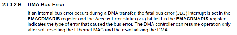

  • I am not the expert on EMAC, but I think you can generate the  EMAC_INT_BUS_ERROR by programming the DMA to read from, or write to non-existent memory. You will also get a DMA error. After the error the EMAC controller needs to be soft reset.
    (My answer is being reviewed internally, but I wanted to get you something so you know we are working on your question.)
  • Hello Amir,
    As Bob mentioned the EMAC_INT_BUS_ERROR can be generated by making the EMAC's DMA fetch to access a location which is not is the addressable space. Also as mentioned by Bob, a soft reset of the MAC and initialization of the stack is required.
