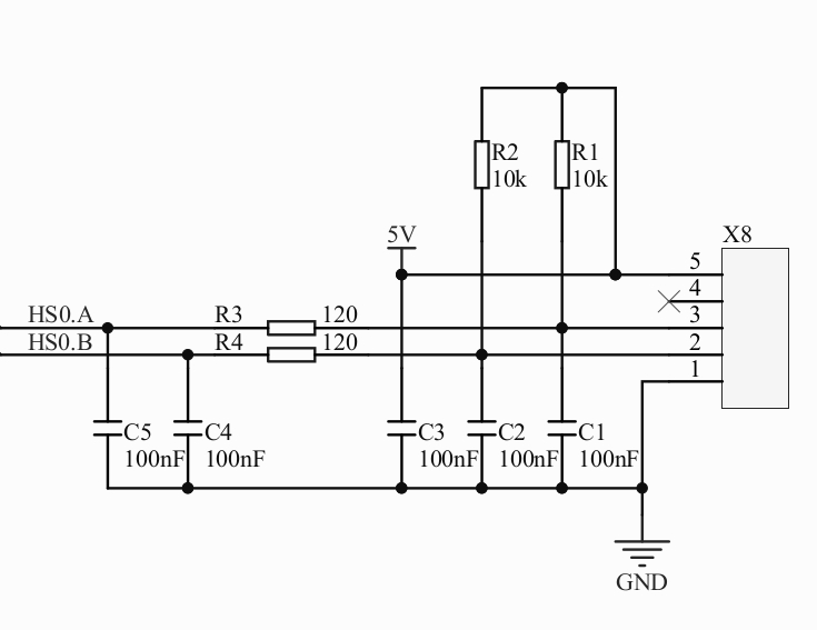

    you can see the schematic of the input circuit below:
    The HS0.A and HS0.B signals are connected to the MCU via a Schmidt trigger (74HC14). Is it not enough to filter out glitches? How should I design / rework the input stage of the QEI?
    Norbert
  • Thanks for the schematic - it does add neat detail - yet there (remain) many unanswered questions - limiting my/others' diagnosis...
    Perhaps your re-read of my initial post will prove more instructive than my (repeating) those questions, here.   I presented a, "Multi-Branch" diagnostic guide - yet (only) a single branch - captured your interest/response...
    Do note that it has NOT been (yet) established that your encoder is "glitching" - and the NEW DATA you've just presented (use of HC14) has (almost) eliminated "glitching" from consideration.   Still - it IS important that the HC14 be physically close to the encoder - insuring short/direct "encoder to HC14 input connections."
    The resistors & caps you've added to the MCU's QEI inputs should be "well matched in value." (so as NOT to negatively impact the encoder's timed, quad output)
    Of HIGH interest is the "unanswered" question regarding: "Number of boards (MCUs) & encoders - which exhibit this issue!"   (especially - do ANY assemblies work - w/out exhibiting this issue?)
    I only detect this issue on single board. I turned on glitch filtering with the maximal value (the datasheet determines as system clock periods). It seems, to helped me, but doesn't eliminate the entire problem.
    Does this imply that "this issue" does NOT occur upon (several) other boards?    If that's the case - the MCU and/or integrity of the QEI routings/connections - for that "single board" are suspect.
