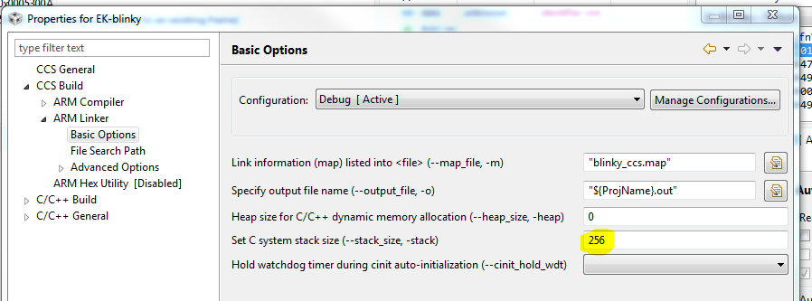

  • I am sorry that you are experiencing problems. Some of your concerns about the stack are handled "under the hood". Let me explain what is going on, and perhaps suggest some ways that we can customize the stack for more efficiency.
    For many of our example projects, the reserved stack space is quite small. The size of the stack can be changed by right clicking on the project name and  selecting "Show Build Settings...". Then  expand "CCSBuild" -> "ARM Linker" -> "Basic Options" and you can set the stack size.
    Bob, that setting for the stack size is for the TI ARM compiler. Whereas I think Markus was asking about the GCC ARM compiler which has different CCS project properties and different start-up code.
