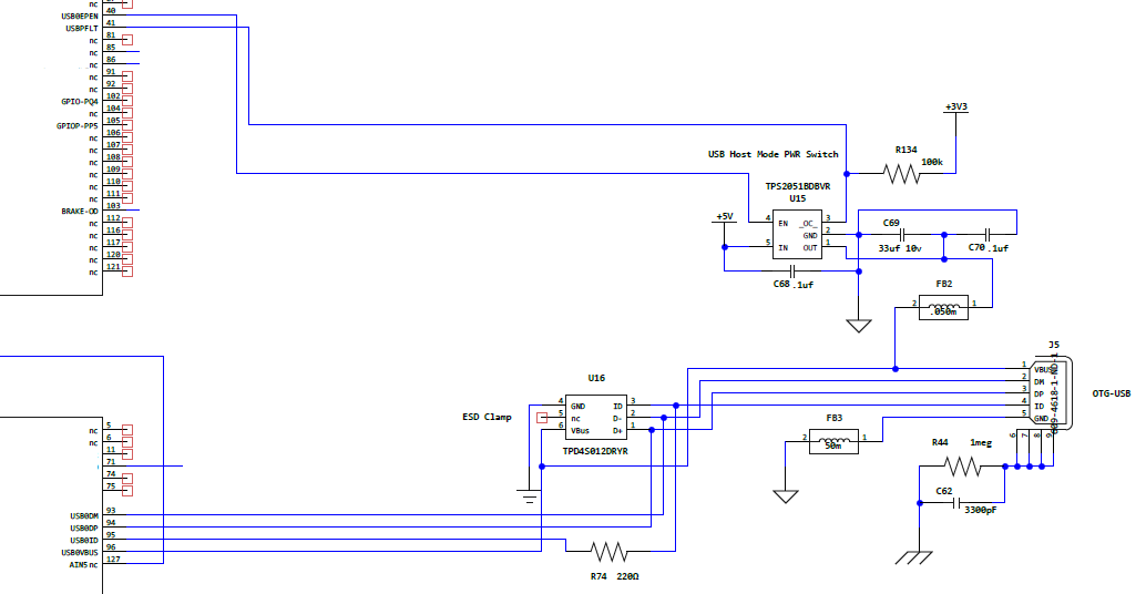

    So your +Vbus supplies power to USB device in host mode but PQ4 has to be enabled to output enable U4 TPS2052 to switch +5v into GTO port. Recall EK-TM4C1294XL the USB host was enabled via GPIO PQ4 port configuration defaults to open drain, disabling +5v from GTO device mode default where +Vbus is input.
  • I changed a few things, using a TPS2051 and placing USB0EPEN on PA6 (pin 40) instead of PD6. I modified the source to reflect these changes, and as I mentioned the USB memory stick host firmware works fine. The memory stick that I'm testing with (which happens to be branded from a Texas Instruments conference!) lights up to show that it's receiving power, and of course the access commands work.
    I also moved the power default detect signal to PA7, allowing hardware peripheral power fault input pin function USB0PFLT to be enabled. This is an improvement over the EK-TM4C1294XL reference circuit, which uses a generic GPIO on PQ4 for some reason. I adjusted the source to reflect the use of this official pin.

    Note that the call to USBHCDPowerConfigInit() takes bit fields that seem to allow actions to be taken to disable USB0EPEN when USB0PFLT goes low or high, as appropriate. Most chips we might use seem to be active low, which is easily supported with the right bit field. I have not reviewed the usblib sources to confirm that this works. My brief tests of changing the examples seem to make things less functional, so I have more to investigate.
    	USBHCDPowerConfigInit(0, USBHCD_VBUS_AUTO_HIGH | USBHCD_VBUS_FILTER | USBHCD_FAULT_LOW | USBHCD_FAULT_VBUS_DIS);
