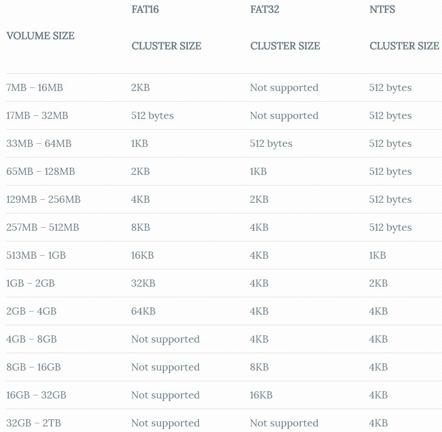

    My Flash device does not support a 512Bytes erase. It supports a minimum of 4KB at a time.
    So sector size will be 4096 in my case.
    As you said, if FAT32 needs a min of 65527 clusters, then the minimum size of the Flash device should be 256MB? Please correct me if I am wrong. . .
    Which FAT filesystem is suitable for 4MB Flash device?
    Is FAT16 possible on 4MB Flash?
    If possible, will the FAT16 formatted device be mounted on windows as a USB MSC device(as in the case of SDcard)?
    Flaby
  • Hi Flaby,
      Please take a look at the below table. If your flash sector is 4kB then your volume size needs to be at least 257MB. Please also reference this link.
  • Hi Charles,
    Thank you so much for clarifying my doubt...
    I have to go with exFAT since the Flash size available for me is 16MB Max.
    As you said, since FAT32 needs minimum 257MB, I cant go for that.
