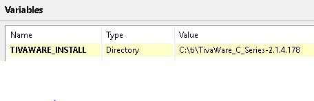

    My vars.ini file points to my TivaWare Install:

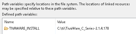

    When I check my Linked Resources in Window->Preferences->General->Workspace->Linked Resources, I can see TivaWare there:
    Same for my build variables in Window->Preferences->Code Composer Studio->Build->Variables

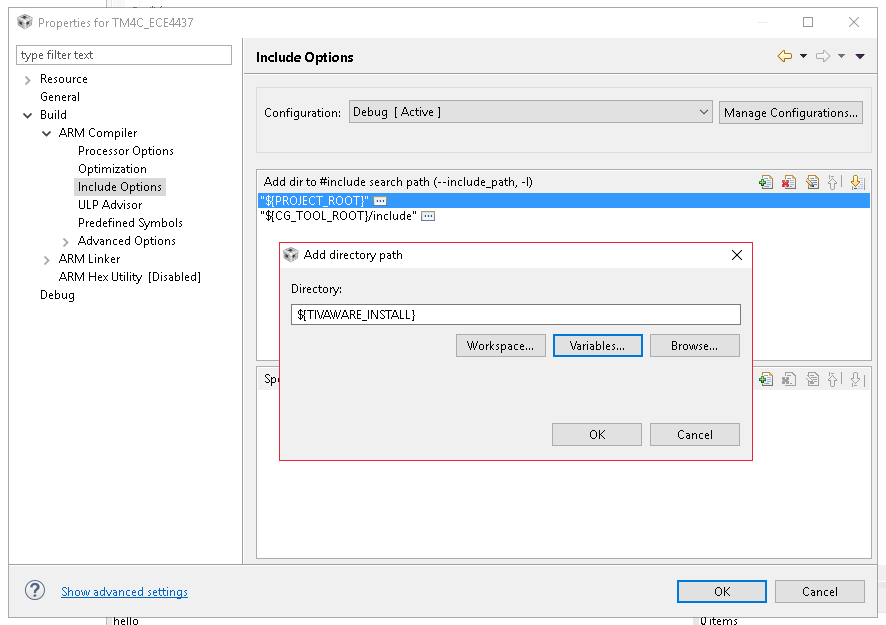

  2. I added the TivaWare’s include path in my specific project’s properties:

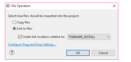

  3. I linked driverlib, usblib, and sensorlib by adding their .lib files to the project like so:

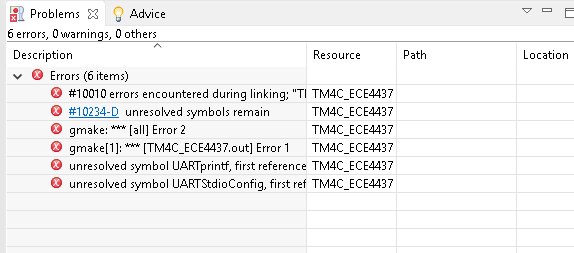

  4. I copied/pasted the hello example to ensure that everything was working. I then cleaned/rebuilt and I got the following errors:
Does anybody have any experience with fixing issues like these?

  • Seems you have to add uartstdio.c and uartstdio.h files to your main project, then you insert #include "uartstdio.h". These and any files that are located in the utils folder aren't automatically included in your project when you compile, if I'm not mistaken.
  • Helder,
    Thank you for jumping in and helping. You are correct. The examples in TivaWare in the "Peripherals" directory are not board specific and do require some additional configuration of the project. If the example uses uartstdio.c, I just copy that file into my project.
  • This is the correct answer. I didn't realize the utils weren't included automatically, as I had a feeling that such was done when I inserted the include path for TivaWare in the project's properties.
    Thank you both Helder and Bob for helping me out, it builds properly now!
