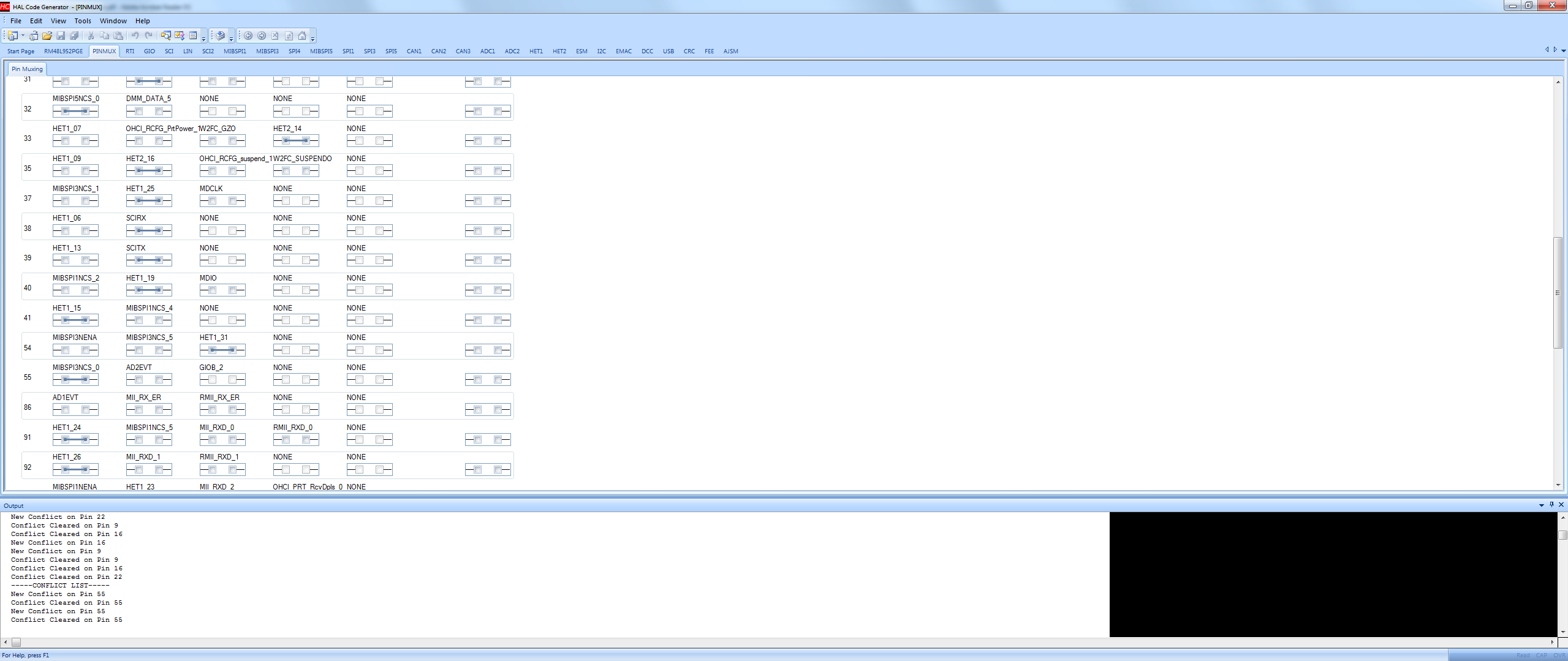

I am using HalCoGen for my RM48L952PGE. I want to use both Mibspi3 and GIOB. When I select both of them in the pinmux tab, halcogen automatically makes the GIOB[2] connection on pin 55, this connection is greyed out so that i may not remove it.
'Use GIOB_2 for disabling slected HET2 PWM outputs' is not selected.
If i then select it and unselect it the GIOB[2] connection is removed, conflict is still listed, I need to remove the Mibspi3Cs0 connection and make the connection again for halcogen to set it right.
This is my result:
Is this a bug in HalCoGen or is it not possible to use this pin like this?

Hi Karel,
After you enable GIOB, you have to check then uncheck the option "Use GIOB_2 for disabling selected HET2 PWM outputs" to disable the GIOB_2.
Yes, it is a bug. I will report to HalCoGen developer. Thanks
