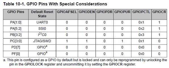

  • Interesting, can you check the backside with a scope? PF2 (J4-1) is the LED control and PD7 (J4-9) is the LCD reset.
  • Bob - perhaps deserving of (almost) equal interest - is not "PD7" one of those (just discovered) pins defaulting into NMI?
    Poster's LCD (may) just have escaped, "Refusal" status/label...
  • My understanding is that NMI is an optional configuration for PD7. From the datasheet section 5.1 where it refers to PD7 and PF0: "The NMI signal is the alternate function for two GPIO signals and functions as a GPIO after reset."
    But you may be on to something. The pin must be unlocked to reconfigure and this software needs to reconfigure it from an input to an output. I am not seeing that in the example code. (My life would be easier if I had a Kentec display booster pack to play with.)
  • I don't have a display, but when I run the code on my EK-TM4C123 I see both PD7 and PF0 go low and toggle high. Let's see what Arjun gets.
  • I am (almost) certain that PD7 requires the same "unlock" treatment as does PF0 - and the supporting fact (LCD Refusal) - raises the "suspect status" of PD7.
    Presented here is the relevant "GPIO Signal Inventory" from the most recent TM4C123 manual we have:
    I am (almost) 100% certain that (both) PD7 & PF0 "Default to NMI."     (I would bet money upon that.)     Now NMI is - as you rightly state - an input configuration - although I suspect that it performs (somewhat) outside of "normal" user expectations.     Those users seeking to employ (either) of those pins as GPIO Output (and possibly to a more "normal" GPIO Input) must perform the "Pin Unlocking Procedure - proper for that pin.
    The Lcd (must) be seeking a GPIO Output (likely active low - I've not RTFM) to bring about a Reset - and the pin's default as NMI/(special) Input - appears outside of proper usage!
    Your discovery of "toggle activity" upon PF0 & PD7 - unless one or both have been "unlocked" - then set to output - is beyond my (and perhaps others') explanation...
