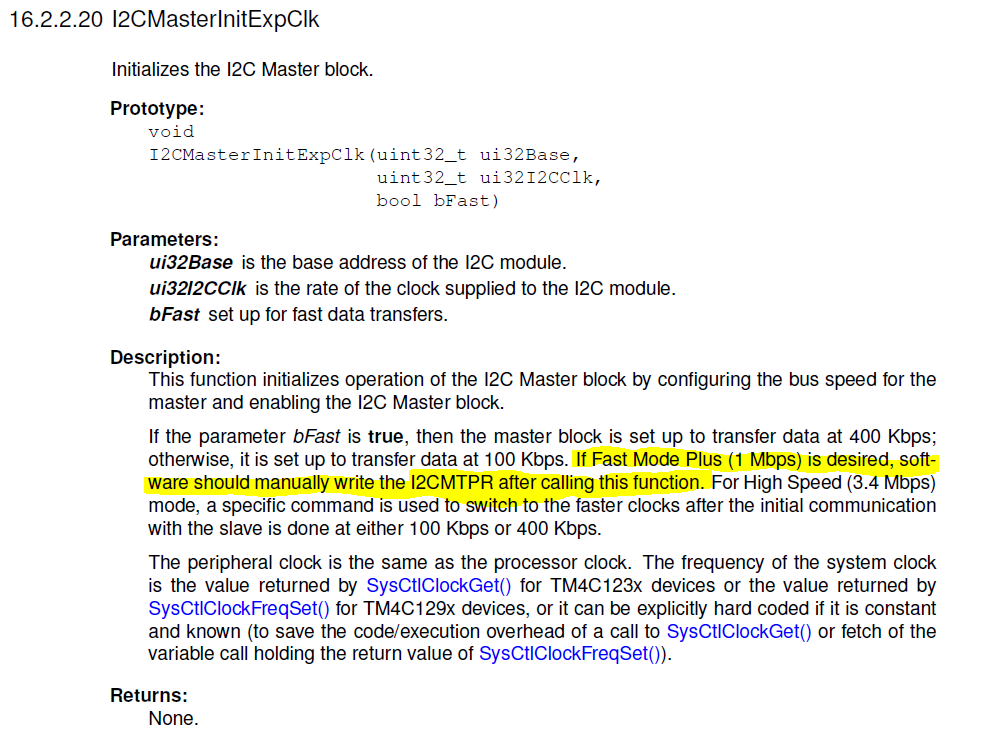

  • As described in section 16.2.2.20 of the TivaWare™ Peripheral Driver Library User's Guide, you should call I2CMasterInitExpClk() and then change the I2CMTPR register immediate after the I2CMasterInitExpClk() function returns.

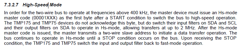

  • I am not an expert on the temperature sensors, but you must initiate the communications at 400K baud and follow the sequence described in section 7.3.2.7 of the TMP75 data sheet.
  • Then to change the I2C clock, you can use the equation from step 2 of your original post, but use your desired baud rate instead of 3,400,000. If you are running the TM4C123G at 80MHz and want a 2MHz I2C baud rate, you can simplify the equation as the value of ui32TPR will be equal to 2. That will give an actual baud rate of 1.9M baud. (The closest we can get to 2M baud with an 80MHz clock.)
